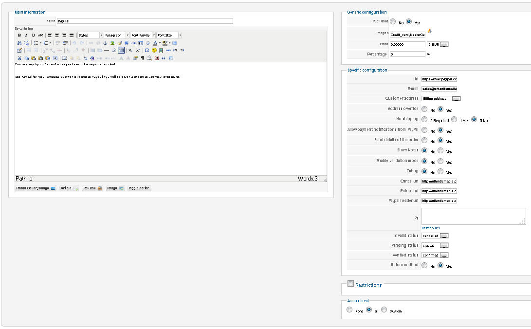

12 years 8 months ago #133241
Hi Sjaak,
Can you show me how did you configured your Paypal payment method through some screenshots ?
Thank you :).

12 years 8 months ago #133247
HI Mohamed,
Thanks for your quick reply.
No problem, I should have done that with my first post, already :blush:
Sjaak
