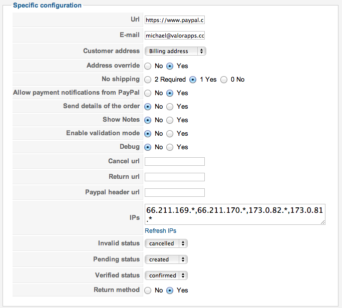

Here is a screenshot of my settings:
Could you please help me? Please guide me on what to do.

In the configuration of the PayPal payment method in HikaShop, you can configure what you want to do with a pending payment with the "pending status" option. If you set it to "confirmed" the system will validate the order and send the notification emails for pending payments. But if you set it to another status, no notification will be sent to the user. That's the normal behavior.
Regarding the fact that PayPal set the payment status to "pending", you need to see that with PayPal. There is nothing we can do to help you on that. It's probably that PayPal cannot validate the payment immediately and thus it has to wait before doing so.
