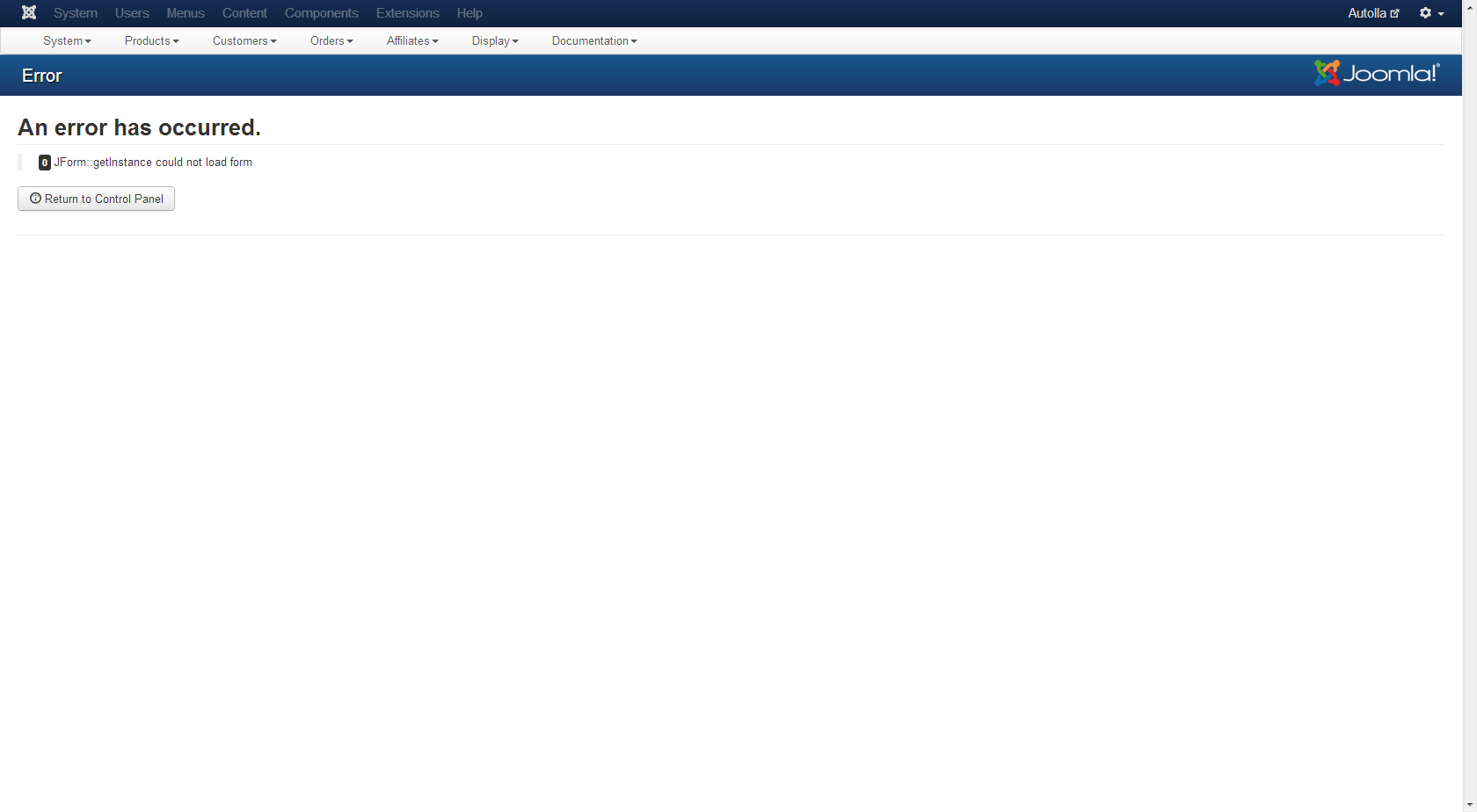

Hello there,
I have a problem when I create a new method of pay with the name HikaShop common payment API plugin.
This is the print screen of the error
  • Posts: 86220
  • Thank you received: 14223
12 years 8 months ago #138627
We're not able to reproduce the problem. Which techjoomla payment plugin are you trying to use ?

In all cases, I will check the plugin on our end, and solve the problem if it come from our end.
EDIT:
The plugin is working fine, but in the payment methods list, you must not click on the hikashop common plugin but on the PayU one.
I correct the code to remove the hikashop common in the payment methods list.
Last edit: 12 years 8 months ago by Xavier.
