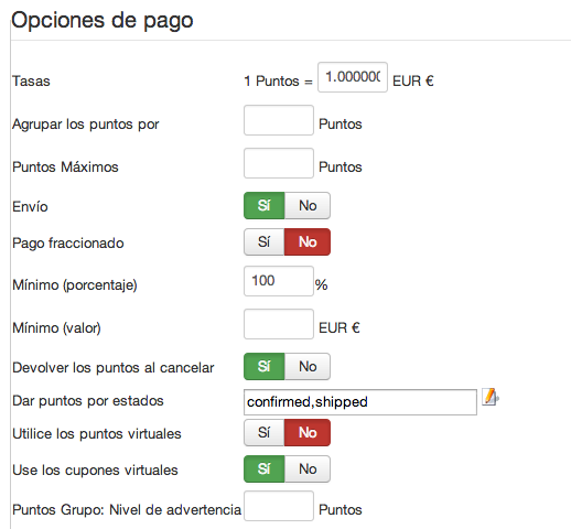

Good afternoon, I resort to this means, I do not find anything on the network, or in this forum.
I have the AlphaUserPoints component installed HikaShop along recharging system by Paypal, so far so good.

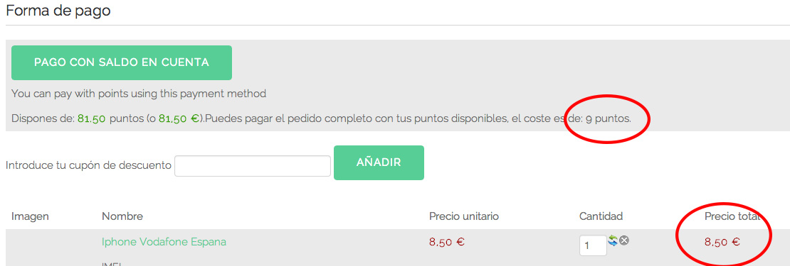

The problem is that when I try to pay for an item, the price always rounds, as seen in the picture.

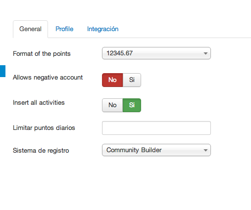

I think I have the options correctly. Would appreciate a help from someone to present the same problem as me.
Thanks in advance!

The price doesn't round, but yes, the points are always rounded in order to be integers. There is no option to change that as that's the normal behavior.
You would have to edit the code of the AlphaUserPoints if you wanted to change the rounding precision to 2 decimals.
For that, you should change the line:
return round($pointsDecrease, 0);
to:
return round($pointsDecrease, 2);
in plugins/hikashoppayment/userpoints/userpoints.php
