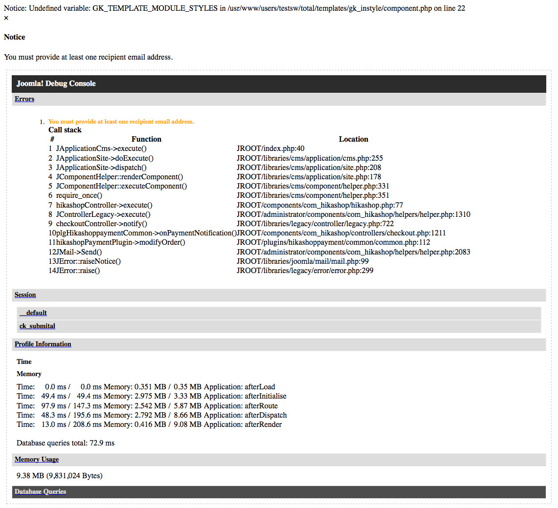

Can you turn on the debug mode and error reporting options of the joomla configuration and try again and do a screenshot of the page with the issue ?
  • Posts: 13
12 years 7 months ago #140718
Thank you again for your help. I hope that this helps.

12 years 7 months ago #140769
That's really strange. This means that the payment gateway redirect the user to the payment notification URL but the plugin of techjoomla doesn't provide the return URL for the redirect to the thank you page.
You'll have to add the line:
'return'=>HIKASHOP_LIVE.'index.php?option=com_hikashop&ctrl=checkout&task=after_end&order_id='.$data['custom_str1'],
after the line:
'txn_type'=>'',
in the file plugins/payment/fastpay/fastpay.php

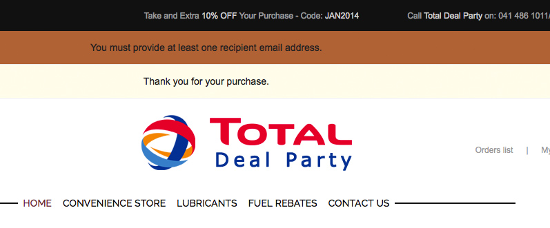

I think that you have just about completed this plugin. I now get a notice at the top of the page that says:
You must provide at least one recipient email address.
And in a new line:
Thank you for your order.
Do you know why we are getting the email address issue?
Is it possible to include the thank you for your order message in the main body of the website instead of in the notice space at the top of the site?
I have attached a screenshot.
Jenn I hope this helps you to.

If you enter a return URL in the plugin options, you can have it go wherever you want on your website with the text you want (for example a thank you joomla article page).
If you want to move around the messages, you can do that in your template (you'll have to ask your template provider for the exact procedure).
Regarding the email error, it means that one of the emails which is sent after the payment couldn't be sent because the recipient email was missing.
Which emails did you get after the payment ? Could you maybe do some screenshot ? That way we should be able to tell you which email is the problem.
