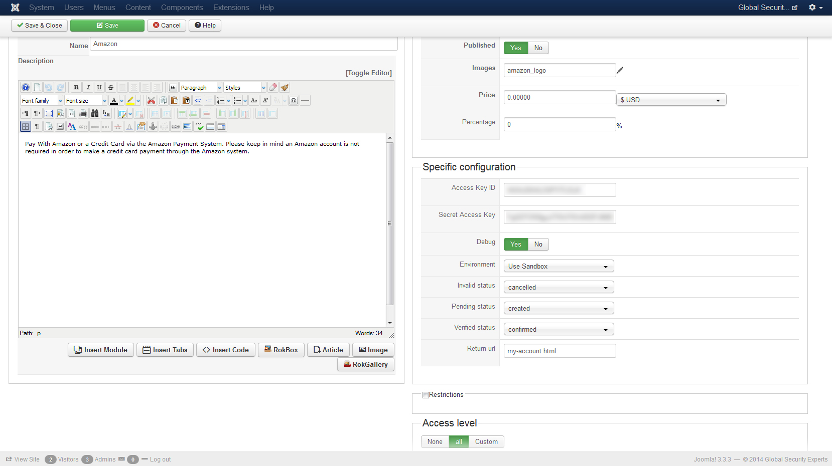

11 years 8 months ago #179993
I'm having the exact same problem. Here's a screen shot of my Amazon payments config.
11 years 8 months ago #179998
1. Did you tried it with a production environment ?
2. Did you :
- Check that the debug mode option is ON through your Amazon payment configuration page
- Test it again
- Check your Payment log file content.
