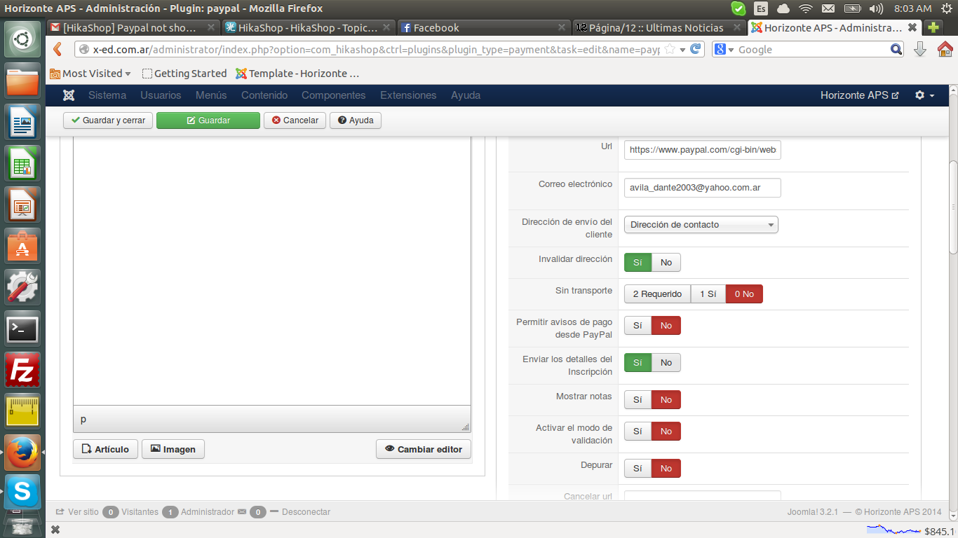

HI,
I`ve configured the paypal plugin with all the information as indicated in the documentatio and in www.hikashop.com/support/faq.html#paym but I still can`t make it to work.
It simply doesn`t show in the payment option.
My purchasing workflow is: Login - Payment - It does not require an other steps since what we are selling are on line courses so there is no fullfillment or shipping needed.
The currency I've selected is supported by paypal and I`ve entered my paypal email address.
Still I can`t make it appear.

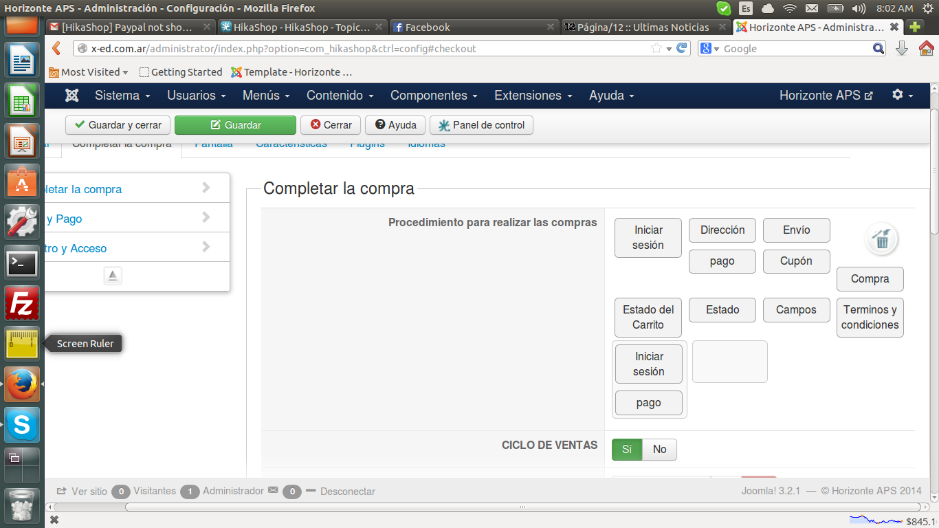

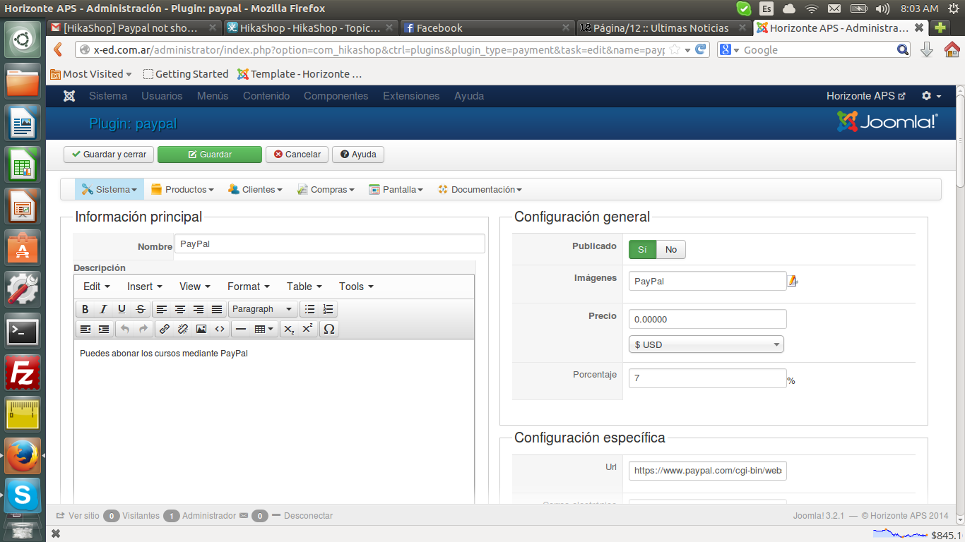

12 years 7 months ago #142419
Can you show me some screenshots of how you configured you checkout workflow ("Hikashop->System->Configuration->Checkout") and your paypal payment method ?
Also can you test it with the "address" added through your checkout process.

12 years 7 months ago #142741
Yes. I must say that my site is in spanish. I hope that's not a problem for you.

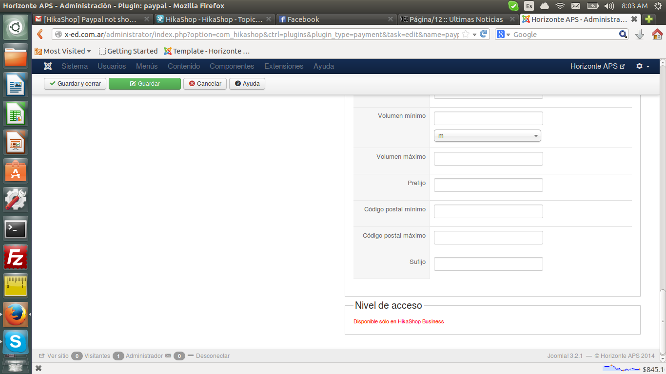

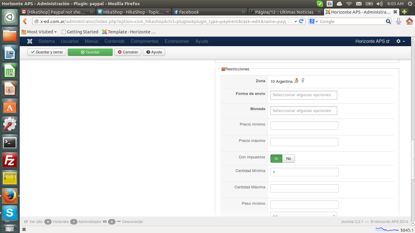

12 years 7 months ago #142745
You should remove the zone restriction in the paypal plugin options. Otherwise, it will only show if your current user address is in Argentina, which is probably not the case.
  • Posts: 21
12 years 7 months ago #142747
Well. I'm trying with both addresses (one in Argentina and one in the States) and it is not showing in either one.
I want the plugin to be shown only for non-argentinian residents
12 years 7 months ago #142820
Ok, but can you unset all your PayPal restriction options, so that we can be sure that it's not coming from this ?

  • Posts: 21
12 years 7 months ago #142880
Ready, I already eliminated all the restrictions and the paypal option is still missing..... :(

I can see that you're using ARS as your main currency on your website but ARS is not a currency supported by PayPal. Change it to USD for example and you'll see the PayPal payment method.

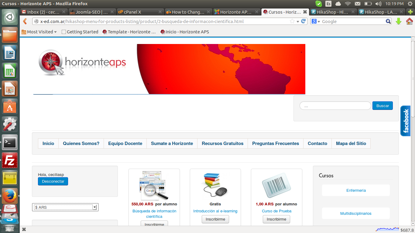

12 years 6 months ago #143165
Thanks NIcolas, I tried to do what you suggested. I enabled the currency switcher module, but whenever I clic on it and hover with the mouse over the currency options, the menu dissapears :huh: .
The product has both prices in AR$ and U$S.

12 years 6 months ago #143228
1. Can you give us a link to the page where you are having the issue so that we can directly test it ?
2. Renaming your product listing content menu will probably do the job, but note that you can also use one of the SEF module mentionned through this thread :

  • Posts: 21
12 years 6 months ago #143287
Here`s the link to one of the productos (courses, actually)
www.horizonteaps.com.ar/hikashop-menu-fo...acon-cientifica.html
