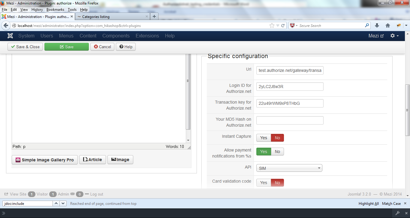

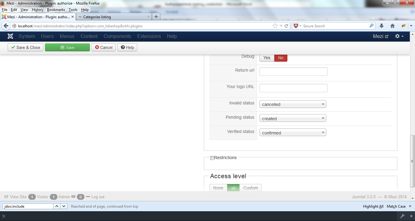

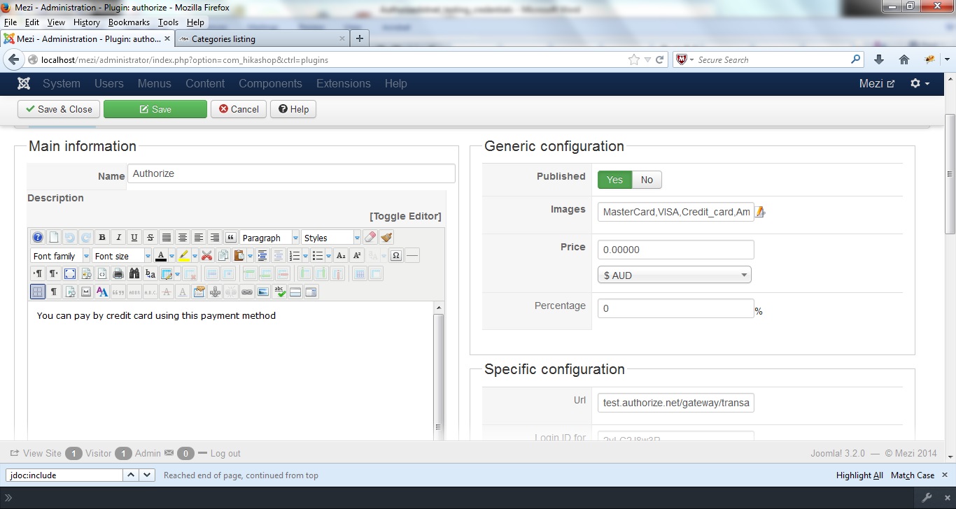

I tried to follow all the payment FAQs and configuration according to my knowledge, but it's not displaying at the front end. My paypal option is showing up but not this authorize.net plugin. I have used Australian Dollar as my currency and I have not restricted to any zone. I have used API login ID and transaction key received from authorize.net during registration.
Please find the attachment to check my payment configuration.

12 years 7 months ago #143500
Note that the Authorize.net payment method only support the USD currency, can you try to set your main currency to USD and see if the Authorize.net payment method is showing ?
