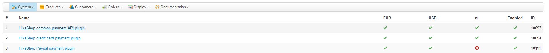

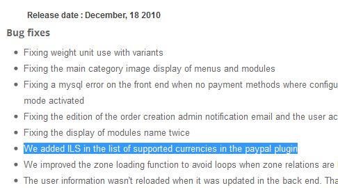

I have defined two payment methods, paypal and credit card but it seems like ILS is not a supported currency even though it states in the improvements that ILS is now supported.
how can I add it?
Thank you

ILS is right listed in the paypal plugin.
Are you sure that the currency you use have the currency code ILS ?
PS : "Standard" is not an HikaShop version number and it is not an HikaShop edition name too.

I know it is listed but see the screenshot I attached previously, there is a little X under the ILS currency code.

Yes the screenshot said that the currency is not supported. That's why I am asking you a screenshot of your currency details (in the System > Currencies) in order to be sure that you are using a currency with the right "currency_code".
The title in the screenshot it not "ILS" but the symbol of the currency, that's why I am wondering if the currency configuration is right.

you are right, that was the problem, I mixed the symbol sign with the code.
