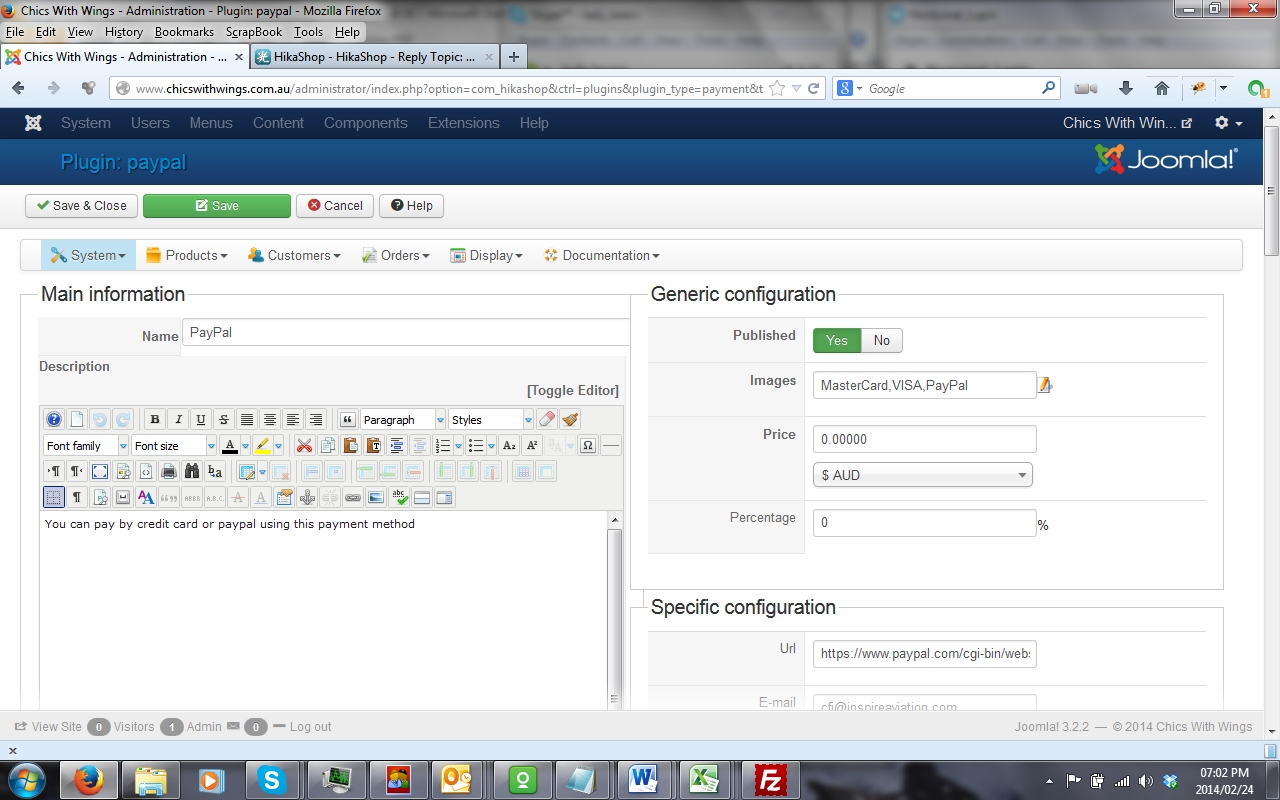

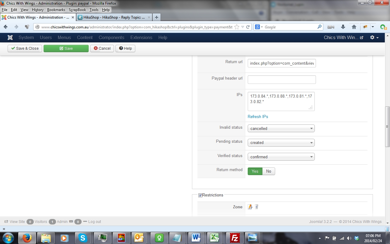

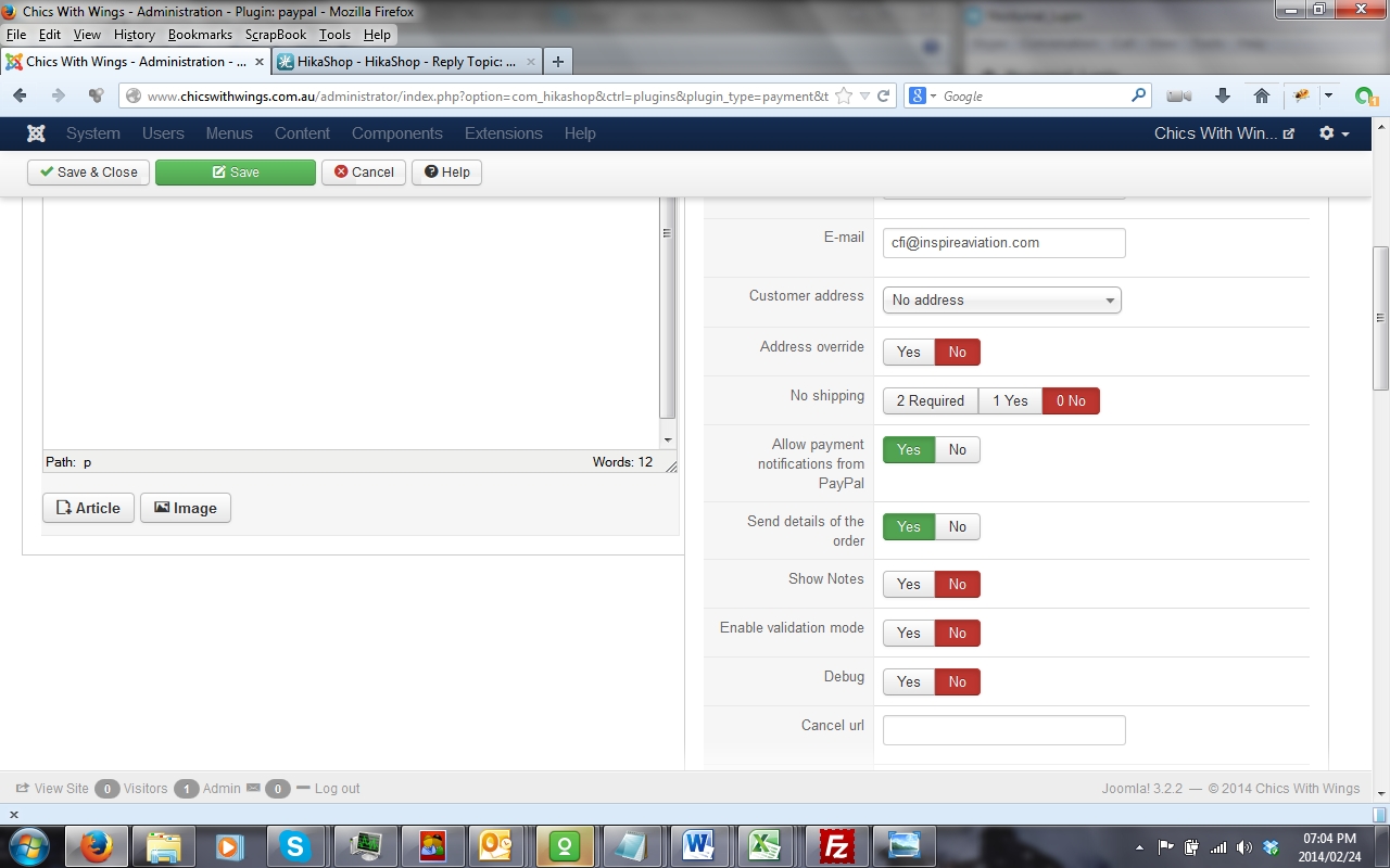

Hi Mohamed
The order got paid for at paypal, and is showing as 'confirmed' in the hikashop orders section. I have taken the screenshots of my paypal configuration.
Please advise.
12 years 6 months ago #145677
Can you unset the "return URL" option and test it again ?
Thanks :).

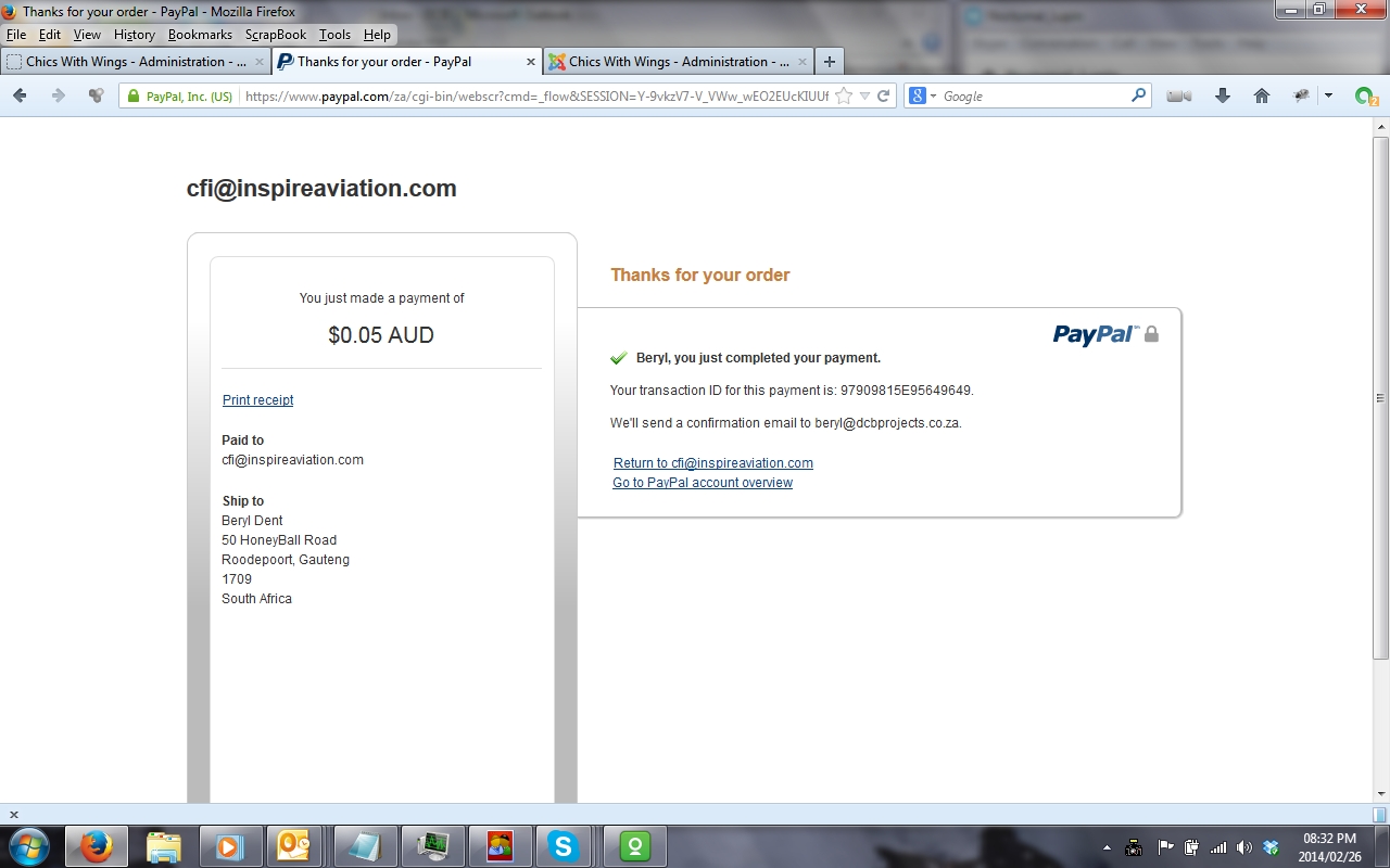

I tried what you said and it still does not automatically redirect people back to the site. I have attached the screenshot of where it gets stuck.
Please advise.
12 years 6 months ago #146064
There is an option in your PayPal account to enable the automatic return on the website.
  • Posts: 14
12 years 6 months ago #146098
Hi Xavier there is the option to add a website address, but this 1 paypal account is being used on multiple websites, all the others are using another cart where paypal express and the API redirects the user back to the site perfectly. Because the account is being used on more than 1 website I have not put the web address in, apart from that there is no where to set a redirect url
12 years 6 months ago #146147
This is the only option I see. As far as I known with paypal "standard" there is no other way to do that.
