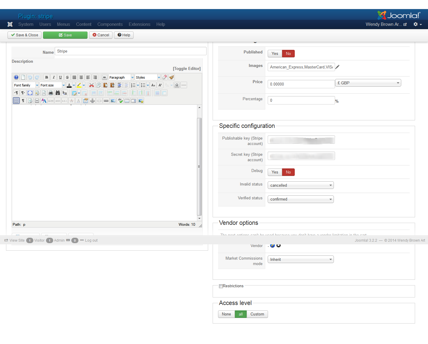

12 years 6 months ago #145539
Can you show me through some screenshots how did you configured your Stripe payment method configuration page ?

12 years 6 months ago #145541
Hi Mohamed
Here is a screenshot:
