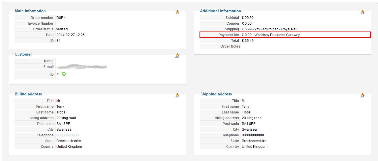

Please find attached a screenshot showing an order that has been paid for (in my case the order status is set to "verified") via the worldpay test system. Notice the red box - this is my issue.

Ok, I thought that you were talking about the total of the order, not the payment fees.
The payment fees are taken from the "price" and "percentage" fields of your payment method.
If it says 0, it means that you didn't enter any price nor percentage for your payment method.

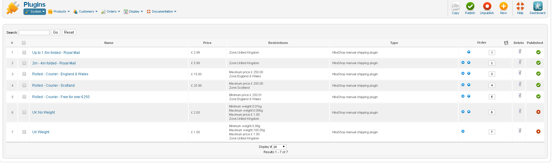

Yes we set up shipping zones for the individual countries in the uk. Since the user is shown his basket before he is shown the page where he enters his details (including his location) then the no payment methods message is shown on the basket page. How can I stop this message from displaying without changing the order of the pages that the customer is shown in the checkout process?

Your red rectangle on your screenshot is for the payment fee (a fee that is added to the order based on the payment method selected by the customer), not the total amount on the line below the payment fee.
The total amount line of the order correctly has the total amount displayed on your screenshot.
I don't understand why you think that the payment fee should be anything other than 0 if you didn't enter any payment fee in your payment method settings ?

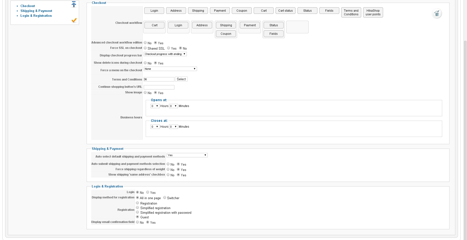

Regarding the message, please provide a screenshot of the options of the Checkout tab of the configuration.
  • Posts: 32
12 years 6 months ago #146637
Hi nicolas,
Please find attached the two screenshots of my setup. At the very first stage of the checkout (on the basket page) im receiving an "no payment methods found" error.

Could you give us a screenshot of your payment method configuration?
