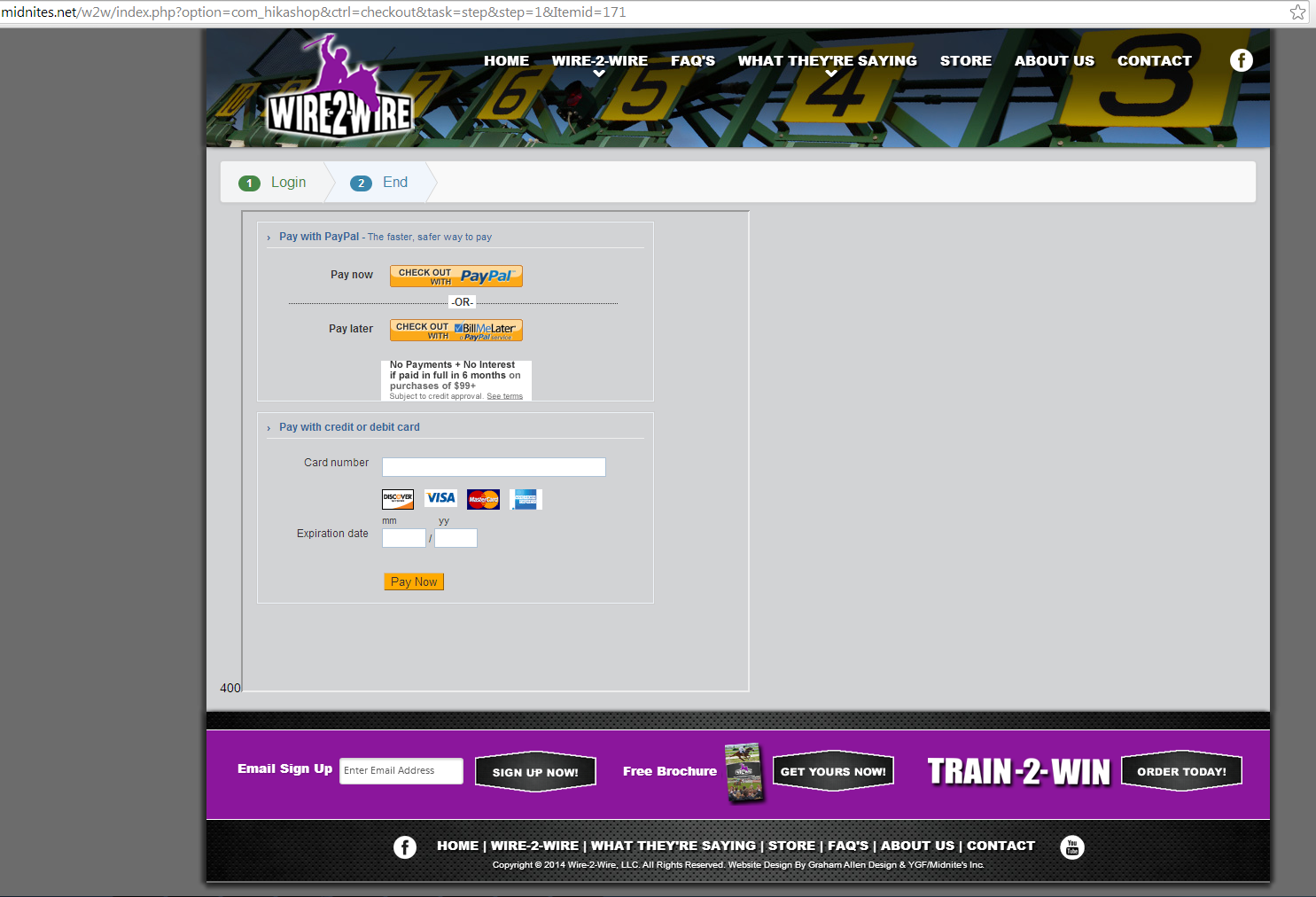

If this plugin isn't already available then WHY is it in the Payment Methods choices inside Hikashop? It's the sole reason we tried your shop.
I'm running Hika 2.3.1, Joomla 3.3.0
We're trying to get it setup and we're having issues. midnites.net/w2w/ when you go to check out there's no way to fill in the info you click on it and nothing happens, and when you look at the code - nothing is there. We have it set to Form, not iFrame in the settings.
We have auto select for payment and shipping turned off (we've tried it both ways).
Lydia
  • Posts: 86214
  • Thank you received: 14221
12 years 3 months ago #158862
The PayPal Advanced plugin has been added only recently in HikaShop. It is now pre-installed in HikaShop. That thread was from a period where it was not available yet in the released version of HikaShop.
I've checked your checkout and I'm getting the error:
" Some required information is missing or incorrect. Please correct the fields below and try again.
Error: Invalid Merchant or Merchant doesn't exist!"
from PayPal. So it seems that the payment method settings are not correct.

I did another test on our website and now it seems to be working fine:
  • Posts: 14
12 years 3 months ago #159143
I spent a bunch of time on the phone with paypal and it magically started working... I think they forgot something on their end. There seems to be a lot of similar issues going on with Paypal advanced and everyone (all programs) that are using it.
