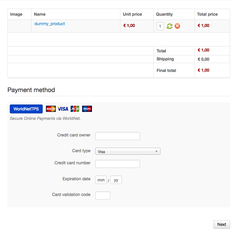

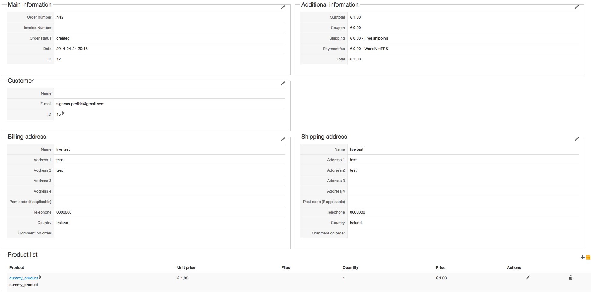

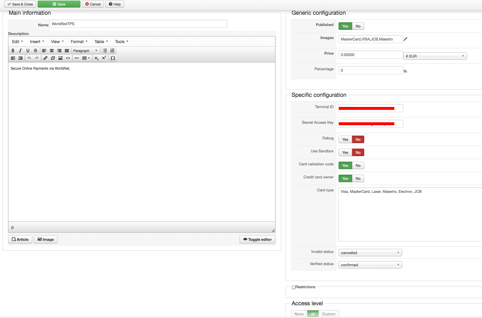

12 years 4 months ago #153467
Hi Mohamed,
Please see attached the screen shot of my plugin payment page,
see attached the checkout payment page, I entered my real card details without my real name and the paymnent was still accepted. The order was created, see the screen grab, but no payment went through to Worldnet.
Please help!
Can you as well answer my question from the original post, how the plugin works, is it an iFrame, how secure it is and if I need SSL?
Do I need to add URL do Live host somewhere in the settings?
Thanks,
Kaska
  • Posts: 86216
  • Thank you received: 14222
12 years 4 months ago #153591
I reviewed the plugin and there is a typo in the code which prevents you from using the non sandbox mode.
Change the second line:
$curlUrl = ' testpayments.worldnettps.com/merchant/xmlpayment ';
to:
$curlUrl = ' payments.worldnettps.com/merchant/xmlpayment ';
And it should be working correctly.
As the WorldNetTPS payment plugin uses the API where the credit card details are entered on the checkout of your website, a SSL certificate setup on your website is highly recommended.

  • Posts: 86216
12 years 4 months ago #153694
That change will of course be in the next version of HikaShop.
If the order is created it means that the payment gateway returned a responsecode with the value A which means that the payment has been accepted by the payment gateway.
If the payment gateway didn't accept the payment but still sent back a "A" responsecode then there is a problem with the payment gateway as it should not be doing that and in that case I would recommend to contact the payment gateway support for help.
The payment plugin we developed for WorldNetTPS only supports the XML integration and not the Hosted Payment page. To support the Hosted Payment page integration, it would basically require to develop a new payment plugin as the mechanism is quite different. It's not just two, three lines of code that you can change in the plugin.
