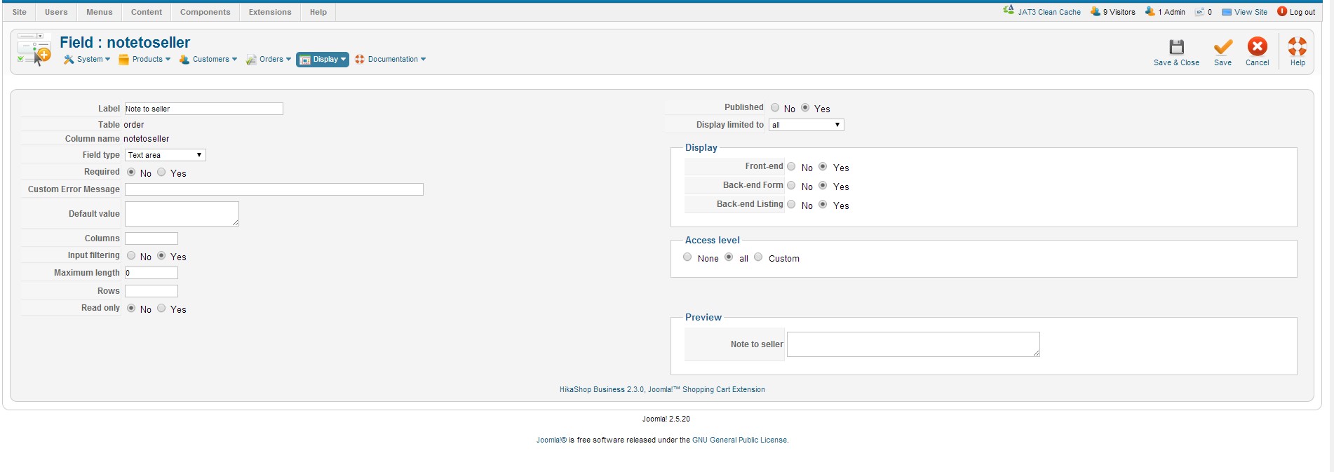

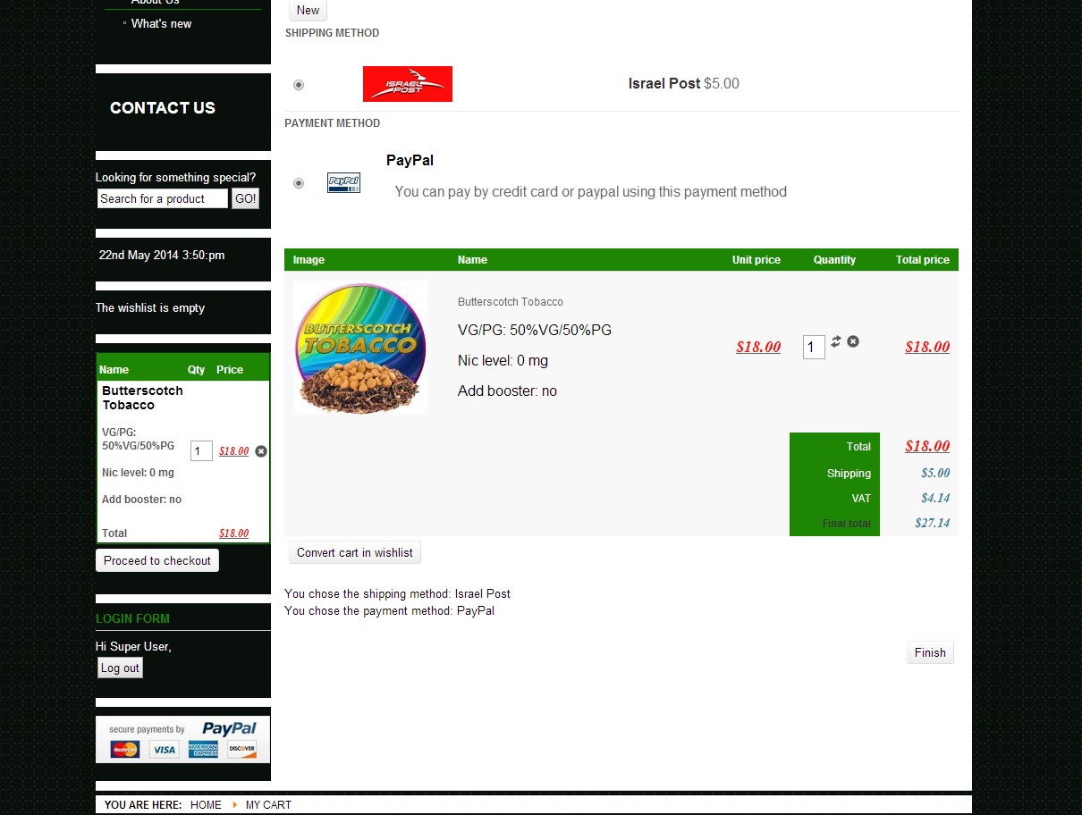

12 years 4 months ago #156957
Ok, I made this but I can't see it in check out. Something I missed?
See attachments.
12 years 4 months ago #156964
Thanks to add the "field" step in your checkout workflow via Configuration > Checkout
