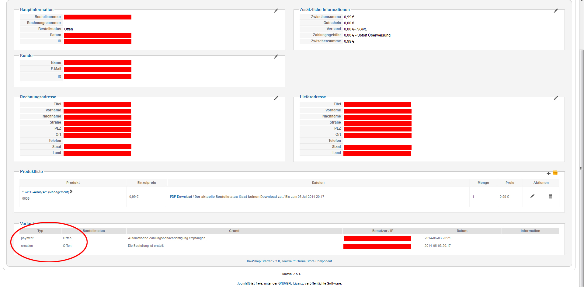

I have a problem with the order status of payments made via sofort.com in a clients shop.
The shop works fine, payment works, just, the status of the order in the orders list shows "offen" (open, the selected status for pending orders).
I aspected the status to change to "bazahlt", means payed, the selected status for confermed orders.
At SOFORT.com they tell me, the show was asking for confirmation and their system confirmed.
Can I check somewhere in HikaShop if the status is realy confirmed?
And if so, why is there a wrong status set?
I don´t think it´s a translation Problem, as I could only select "offen" as pending status, wich, according to a list, found in the forum,
is translated with created, not pending. The translation for pending ("in Bearbeitung") is not in my drop-down list in the plugin settings.

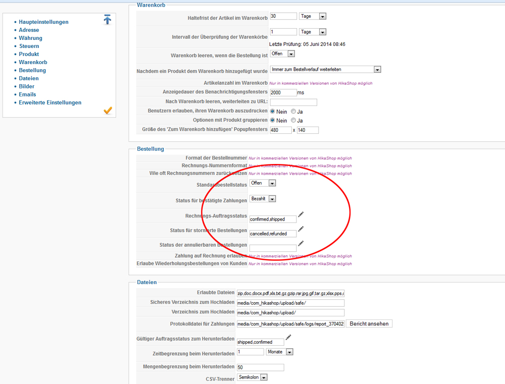

If this helps: the status shown and to be changed in the orders listing is #1 in the list. firbug shows me li id="filter_status_1046_chzn_o_0"
I hope there is a solution, as my client is very sadisfied with the shop and it´s possibilities, but he´d like to see immediately, if a payment was confirmed by sofort.com or just the order.

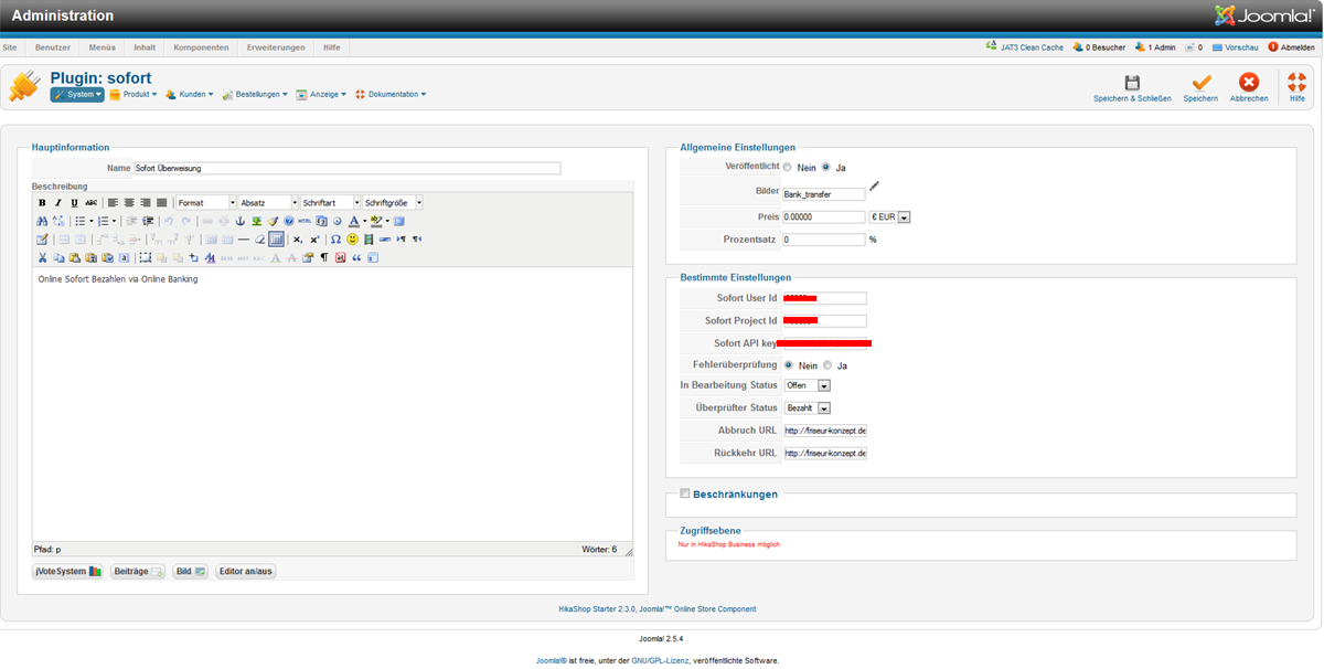

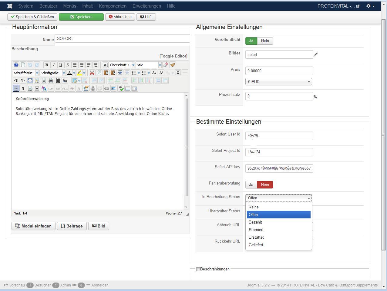

11 years 11 months ago #158388
Hello Oliver,
Can you show me through some screenshots how did you configured your "Sofort" payment method ?
  • Posts: 9
11 years 11 months ago #158570
Hi Mohamed,
there are two screenshots from both status settings. no restrictions selected.
thanx
oliver

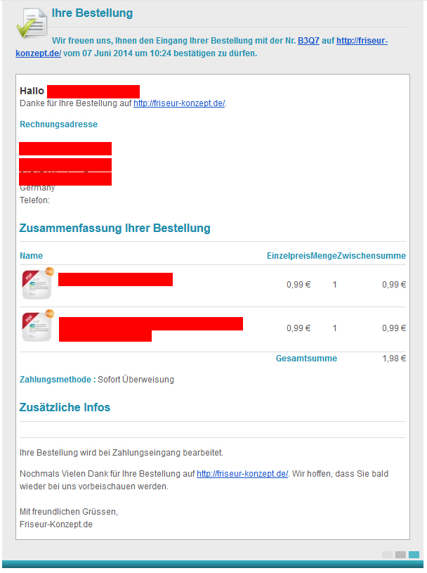

  • Posts: 11
11 years 11 months ago #158712
I had absolute the same problem yesterday!
After the payment via Sofort there was no confirmation email. Sofort confirmed the payment but the plugin still noticed the status pending "offen". I cant find the problem! :dry:
Update: After a call with Sofort they told me that they transmitted all information correctly to the shop.
Update2: With Paypal there were no problems.
So the problem has to be the Sofort Plugin?!
Last edit: 11 years 11 months ago by Stifmeister3.

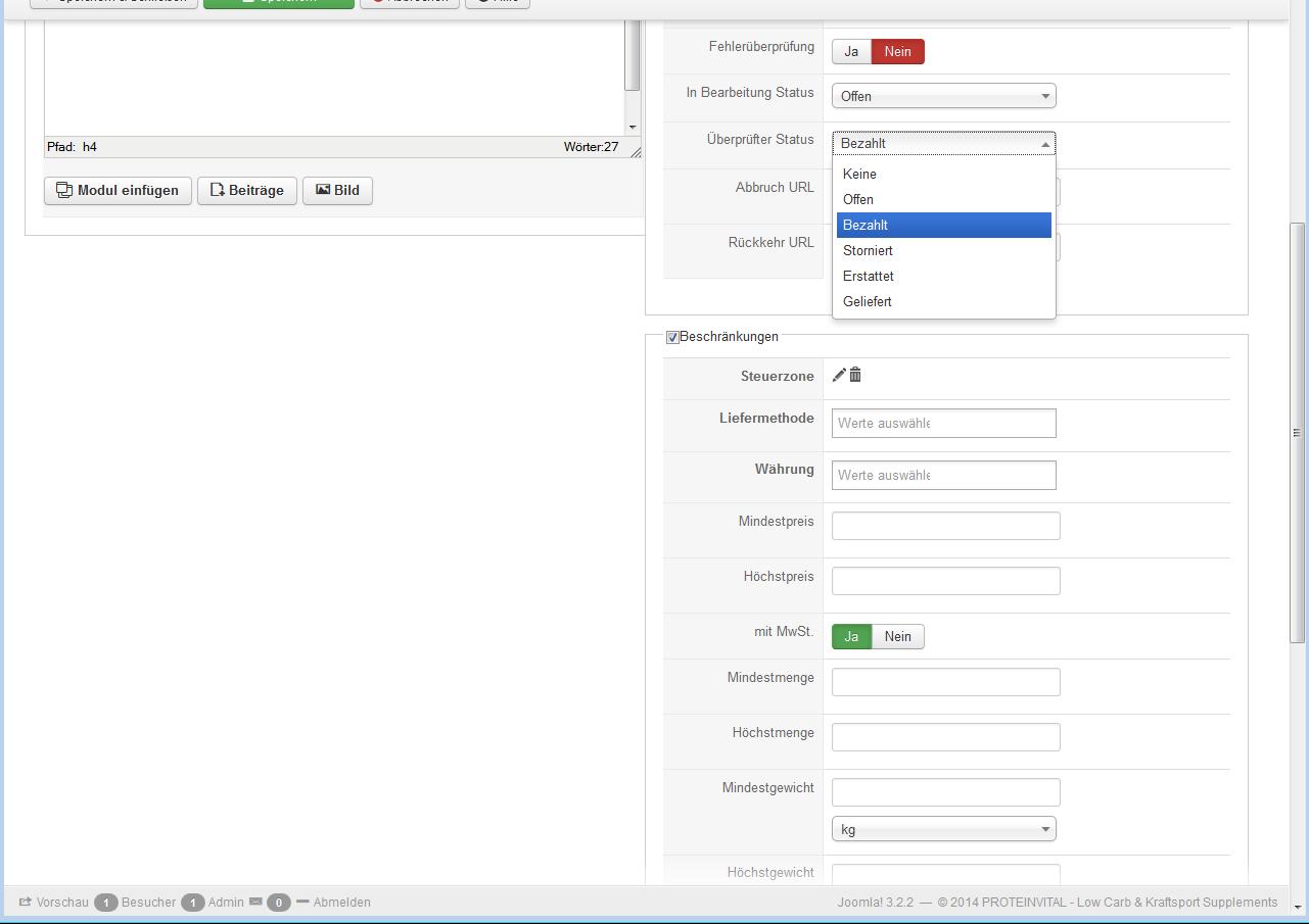

  • Posts: 11

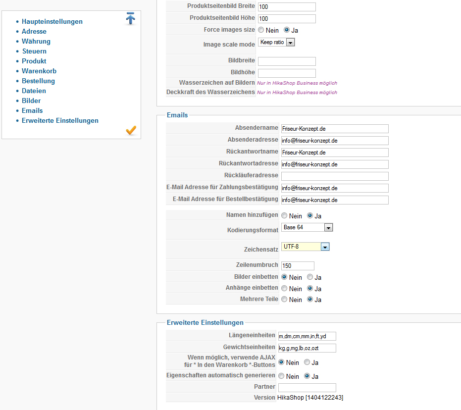

11 years 11 months ago #158969
Hmm could that be the problem?
looks for me correct?!

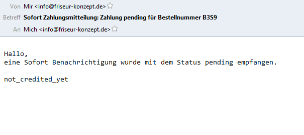

  • Posts: 85681
  • Thank you received: 14042
11 years 11 months ago #159026
It looks correct.
Could you provide a screenshot of the payment notification email that is sent to you as the admin after the payment notification is received ?
I checked the code of the sofort payment plugin and don't see any problem with it.
However, I've seen that one of the status that can be returned by Sofort can be "untraceable" instead of "received" and some other shopping carts accept it as confirmed.
Try to change the line:
if ($transactionData->getStatus() != 'received') {
to:
if ($transactionData->getStatus() != 'received' && $transactionData->getStatus() != 'untraceable') {
in the file plugins/hikashoppayment/sofort/sofort.php and see if that helps.

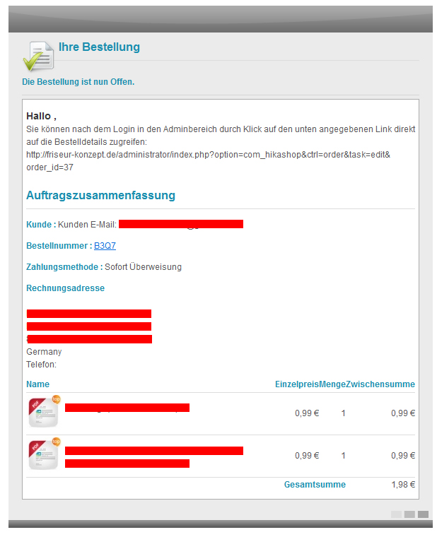

  • Posts: 11
11 years 11 months ago #159294
thanks niclas for your support, but unfortunatelly it is still not working.
Here ist the only email which the admin receives:
Here is the only email which the client receives:

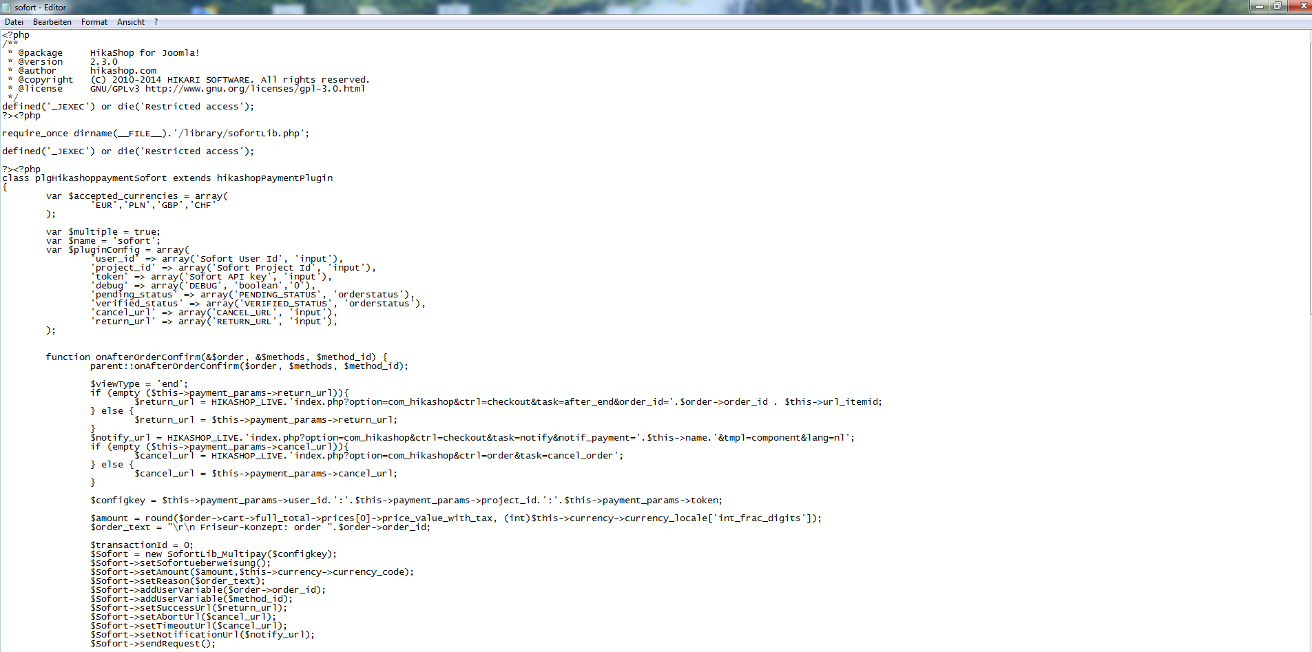

Here is the code of Sofort.php in the file plugins/hikashoppayment/sofort/sofort.php
Thanks for your help.
  • Posts: 85681
11 years 11 months ago #159323
Normally, you should receive also a payment notification email with information on the payment notification.
If you don't receive it, it means that you probably have the "payment notification email address field of the Emails section of the configuration empty. Please enter there your email address and try again.
  • Posts: 11
11 years 11 months ago #159342
I thin it was correct.
looks correct?!
  • Posts: 9
11 years 11 months ago #159609
Hi again,
I followed you conversation with Stifmeister3 and changed the code, you suggested, in my file, but unfortunately no better result.
As a user I get the same order confirmation mail Stifmeister3 showed you immediately, but no payment confirmation. And as admin I can see the same pending status in the orders list. Changing the status, the customer receives the status changed mail - so this workes ... just, the shop can´t see the confirmation by sofort.com.
I´m using the bussiness version, by the way, but i guess this doesn´t make any difference, does it?
Right now, my client accepts to change the status, nevertheless we would appreciate if there was a solution to be found.
best
Oliver

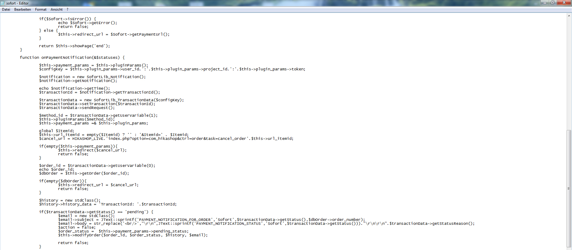

11 years 11 months ago #159605
knowing what are the information that the sofort platform is sending to you after the payment will probably help us to understand your issue, so can you :
- Edit your "sofort.php" file
- add these lines :
if($this->payment_params->debug){
			echo print_r($_REQUEST,true)."\n\n\n";
after :
	function onPaymentNotification(&$statuses) {
		$this->payment_params = $this->pluginParams();
		$configKey = $this->plugin_params->user_id.':'.$this->plugin_params->project_id.':'.$this->plugin_params->token;
- Check that the debug mode option is ON through your Sofort payment configuration page
- Test it again
- Show me your Payment log file content.
Note that you'll be able to check your payment log file through "Hikashop->System->Configuration->Main" by using the "See the report" button of your Payment log file option.

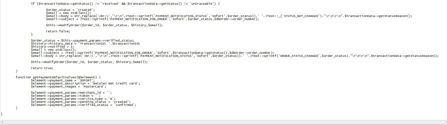

  • Posts: 11
11 years 11 months ago #159736
Totally missed to say that the admin gets this email aswell (when the payment is done):
I guess the problem here:
		$history = new stdClass();
		$history->history_data = 'TransactionId: '.$transactionId;
		if($transactionData->getStatus() == 'pending') {
			$email = new stdClass();
			$email->subject = JText::sprintf('PAYMENT_NOTIFICATION_FOR_ORDER','Sofort',$transactionData->getStatus(),$dbOrder->order_number);
			$email->body = str_replace('<br/>',"\r\n",JText::sprintf('PAYMENT_NOTIFICATION_STATUS','Sofort',$transactionData->getStatus()))."\r\n\r\n".$transactionData->getStatusReason();
			$action = false;
			$order_status =  $this->payment_params->pending_status;
			$this->modifyOrder($order_id, $order_status, $history, $email);
			return false;
			$order_status = 'created';
			$email->body = str_replace('<br/>',"\r\n",JText::sprintf('PAYMENT_NOTIFICATION_STATUS','Sofort',$order_status)).' '.JText::_('STATUS_NOT_CHANGED')."\r\n\r\n".$transactionData->getStatusReason();
		 	$email->subject = JText::sprintf('PAYMENT_NOTIFICATION_FOR_ORDER','Sofort',$order_status,$dbOrder->order_number);
			$this->modifyOrder($order_id, $order_status, $history,$email);
			return false;
		$order_status = $this->payment_params->verified_status;
		$history->notified = 1;
		$email->body = str_replace('<br/>',"\r\n",JText::sprintf('PAYMENT_NOTIFICATION_STATUS','Sofort',$order_status)).' '.JText::sprintf('ORDER_STATUS_CHANGED',$order_status)."\r\n\r\n".$transactionData->getStatusReason();
		return true;

  • Posts: 9
11 years 11 months ago #159766
I added the code as you told me, switched debug on, and ordered..
That´s all i get in the report:
Warning: Creating default object from empty value in /home/.sites/65/site3690616/web/plugins/hikashoppayment/alphauserpoints/alphauserpoints.php on line 685
2014-05-30T09:18:18+02:0010332014-05-30T09:52:58+02:0010342014-05-31T09:32:57+02:0010442014-06-06T21:28:08+02:0010552014-06-10T14:53:05+02:0010592014-06-10T15:07:56+02:0010602014-06-11T12:14:29+02:001062
As far as I can see, that´s an old report, concerning a former problem, I solved with deactivating the alphauserpoints plugin.
Or did I something wrong?
What can I do to get a "newer" report? Empty the cache etc.? But I checked the date of the reports file in the logs folder, it is brandnew!
best
Oliver
