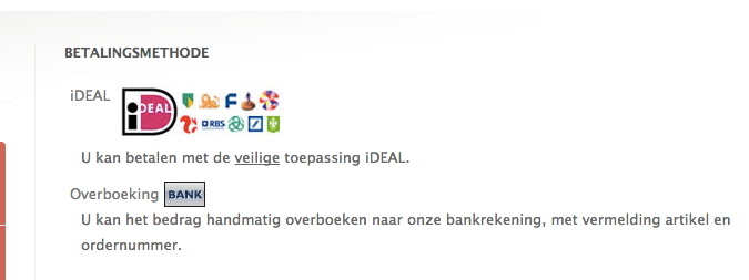

I want two payment methods for the country 'Netherlands'. Those two are showing, but you can't select one.
When clicking on proceed, the ideal payment method is used.
So people can't select 'direct transfer' payment method.
For all other countries the direct payment method should be used, that works ok.
So basically I want that dutch customers can select their payment method. Now they are showing, but you can't select one. (see image)

That's becaue you turned on the "use bootstrap design" option of the HikaShop configuration while your template is not compatible with bootstrap. Deactivate that option and you'll see that it displays fine.
