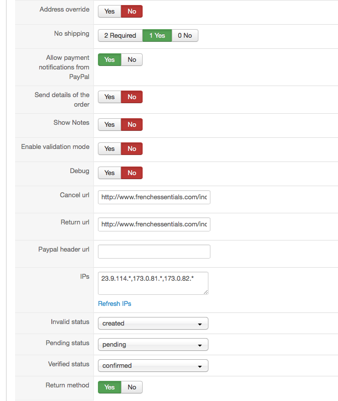

See my screenshot attached.
1/ Should "Enable validation mode" be activated?
2/ I have disable "send details of the order" to prevent 1 cent problems. Is it correct?
3/ Is there any settings I am missing?

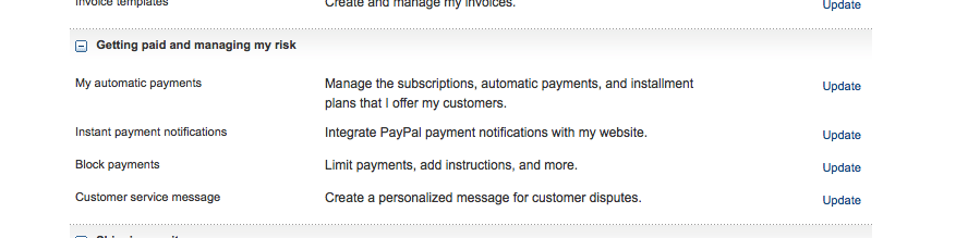

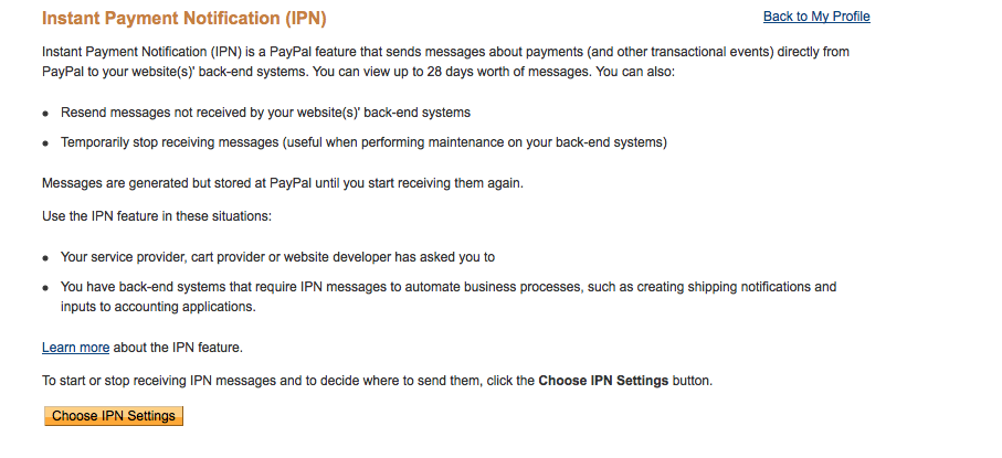

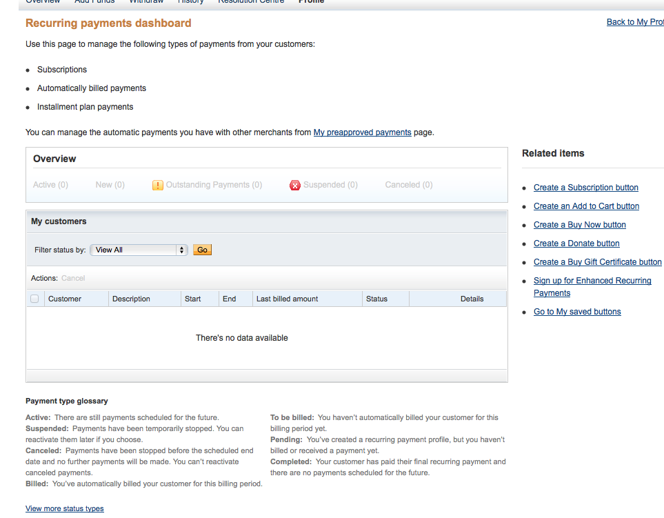

4/ In paypal, Where do you check the automatic validation activation? could you detail?
:dry: I have look but either it ask for IPN, return URL, ... I don't want to screw up everything. (screenshots)

1. If you activate it, the payments will require a validation in your PayPal account and thus won't be validated automatically. So you don't want to turn it on.
2. It doesn't matter in your case as the problem is not from that.
3. The settings in your PayPal plugin are fine.
4. If you don't know where that is, then you didn't change it and thus you still have the default value which is to validate automatically the payments, so it doesn't come from that.

My problem has been sorted by inserting the IP address sent by paypal into the address box in the paypal module. Seems to be working. I didn't realise I had to remove the last ".1" from the end of the address as sent.
  • Posts: 16
11 years 8 months ago #172078
I have removed the end of paypal IPs ".*" and left the 3 first number of the IP. I hope This will work for me too.

B) SOLVED!
I have disable the 'return' setting in the bottom of paypal plugin setting. The orders that came after that, were confirmed!
I have been going crazy for 10 days reading and trying the suggestions in Hikashop paypal doc.
I hope this will help others.

Right, we forgot this "return" option even if the paypal documentation page is pretty clear with it :)
www.hikashop.com/support/documentation/i...form.html#additional
Return method : In some cases, like when you have troubles receiving payment notifications from PayPal, you might need to disable that option. However, most of the time, you should leave that option turned on.
