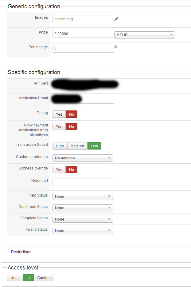

I tried to add description to "product_description" of the product I tried the order with but it didnt help.
You can see the screenshot attached.
Vaclav
