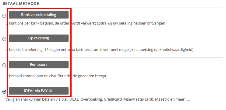

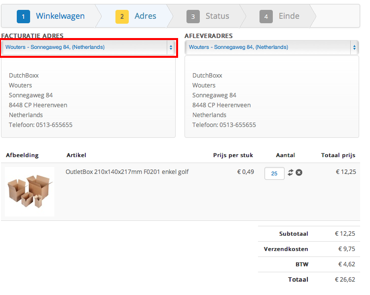

We would like to change the method of selecting a payment options from
radio 'button' to a dropdown selection. Because we are using a number of 6 different payment plugins, the information shown on the checkout page is getting a bit crowded.
Is it possible to change the payment options from radio 'button' to a dropdown selection? (see images)
Thanks in advanced
regards Richard

Hello Richard,
There is no option to do that so the only solution will be to directly use some code customization through the files of the "checkout" view which will require development skills.

11 years 11 months ago #174220
You have to replace the <tr><td>... part into a select.
For the auto submit part, replace the "onclick" into a "onchange".
Some JS will potentially be required to change dynamically the id of the select into the correct one, the id of the selected payment method.
So PHP and some JS knwoledges are required.
