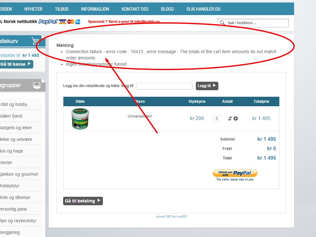

I have activated the Paypal Express as the only payment solution on my test-site.
I works fine.
When a customer shops for more than 900 NOK he gets free shipping, and the freight displays NOK "0" at the checkout. This is correct.
But when I click on the paypal express button I get the message (see picture below):
Connection failure - error code : 10413 , error message : The totals of the cart item amounts do not match order amounts.
This problem only happends when the freight is NOK 0.
How can I solve this ?

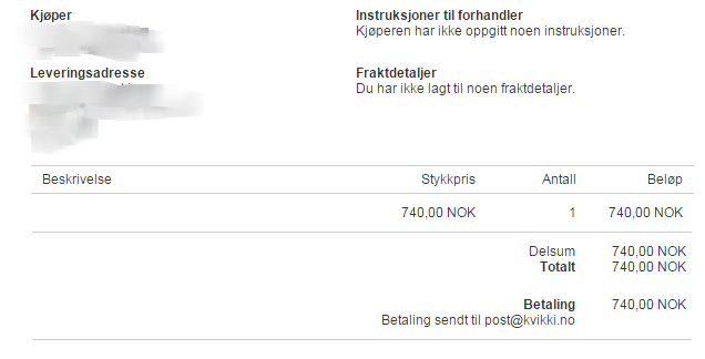

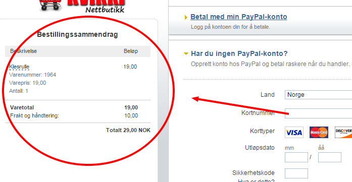

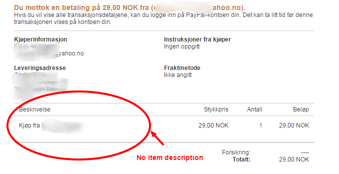

  • Posts: 344
11 years 10 months ago #178149
OK. I now use the Paypal Express Checkout and it works very well.
There is only one problem.
..."The Payment confirmed" e-mails that I receive from paypal does not include any product name, price or freight price. When I log into my Paypal account It is the same problem, nothing is specified, just the total price.
The information displays just fine when customers used Paypal Standard payment.
I have looked in the Hikashop Changelog, and I find this....
"HikaShop 2.3.4
-The PayPal Express Checkout payment plugin now strips the products description to avoid errors on PayPal's end."
I'm not sure if this has anything to do with it ?
Please see enloused pictures below to see exactly what I mean
NOTE: As you can see I have the "Send cart detail to paypal" set to YES in the Paypal express plugin.
This is what my The Payment confirmed" e-mails look like
Any advice ? I use this information for my invoices. So I need it to display.
Last edit: 11 years 10 months ago by river.

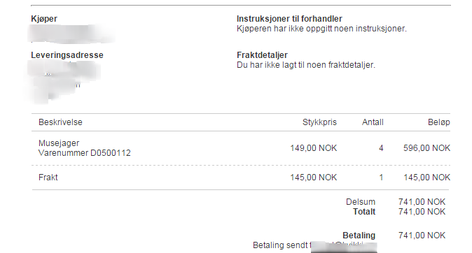

  • Posts: 344
11 years 10 months ago #178238
Ok, tnx for reply. But I think you misunderstand me here
Before when I used the normal HikaShop Paypal payment plugin the Payment confirmed e-mails looked like this (Displaying product name, product code, pcs and freight)
...and now after I have started using the Paypal express checkout plugin the Payment confirmed e-mails looked like this ( with no information, just the total price)
I think this is strange, I need them to display like in the first picture
Any advice ?

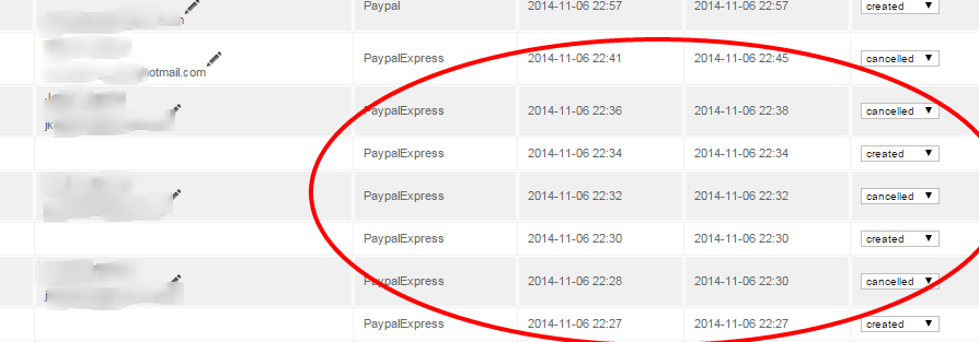

  • Posts: 344
11 years 10 months ago #178591
I think you should do some research on this. For it does not work at all.
I installed this version on my live site.
...and I had two costumers who made a real purchase, one tried to purchase three time in a row.
I receive the e-mail that the order has been cancelled, any no payment was made to my paypal account.
.... but the strange thing is that both name and address is filled out in these orders the orders
I don't understand a thing, so I just activated the old Paypal system.
I I think you should to some more development
