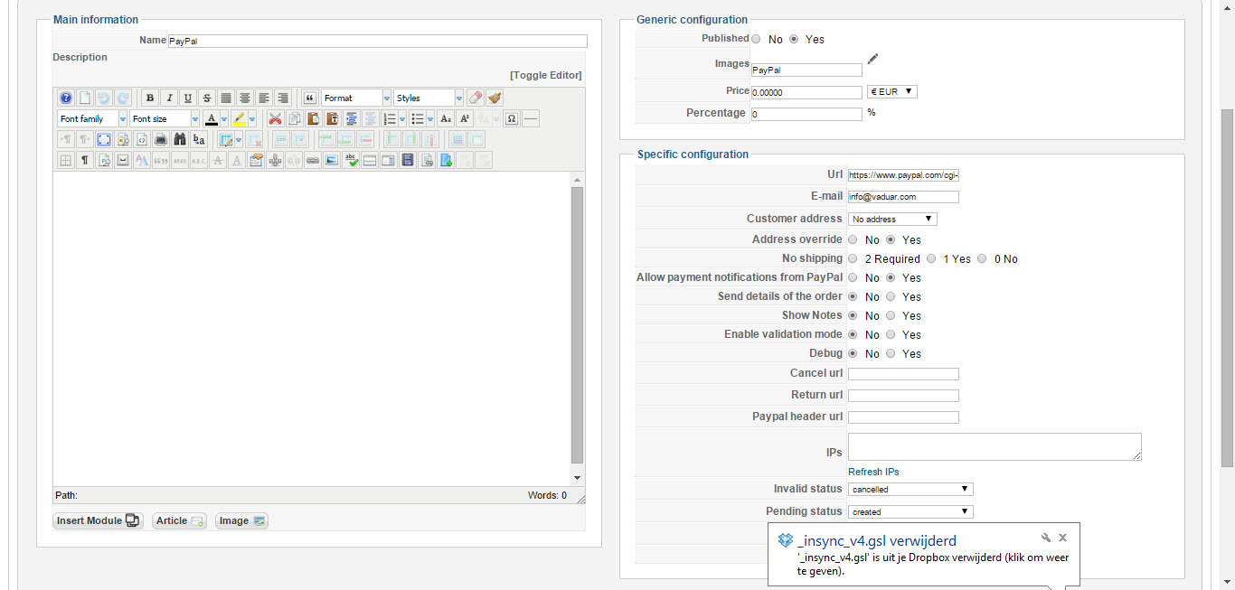

11 years 10 months ago #177042
Can you tell me, where and how do you exactly get that error message ? Can you also show me how did you configured your Paypal payment method through some screenshots ?

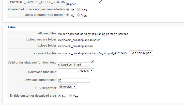

11 years 10 months ago #177330
Ok,
Can you please :
- Check that the debug mode option is ON through your PayPal payment configuration page
- Test it again
- Show me your Payment log file content.
You'll be able to check your payment log file through "Hikashop->System->Configuration->Main" by using the "See the report" button of your Payment log file option.

11 years 10 months ago #178278
Attached a sccreendump and the logfile.
Jan
