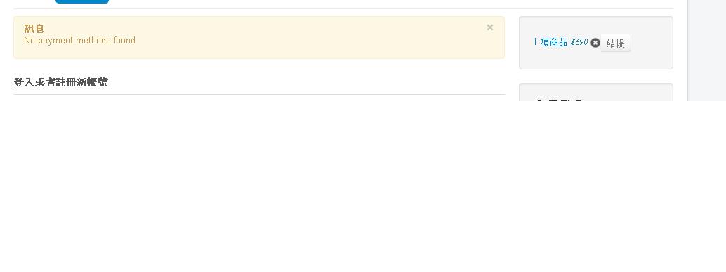

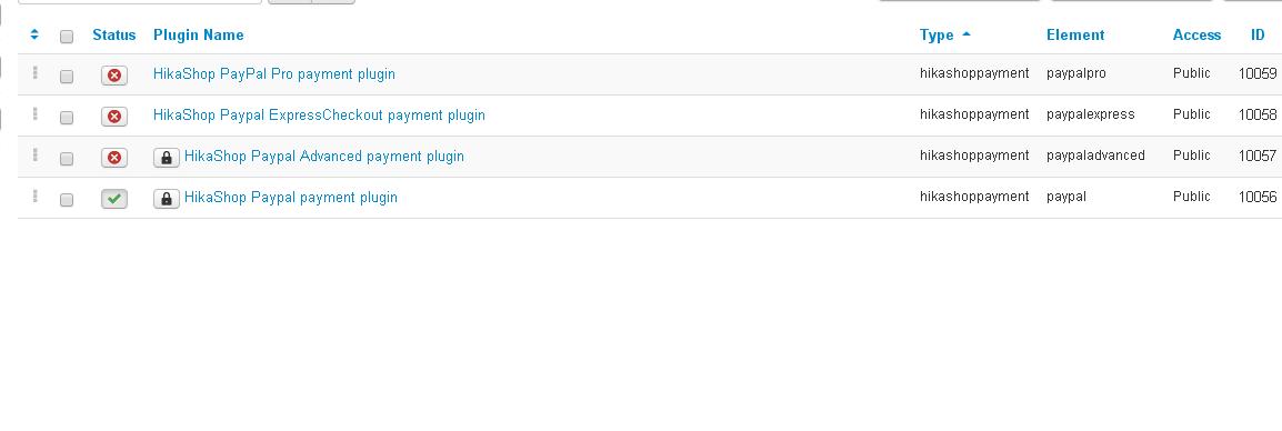

Dear all, I can't process the payment and I have tried all of the Paypal methods, input all of the sandbox info requirement. All of the plug-in and publish has been enabled. But it still shows "No payment methods found". Each time I publish one of the Paypal, like Pro Paypal, I would close the Express and Paypal payment.
What can I do for it? Please tell me. Thank you very much.

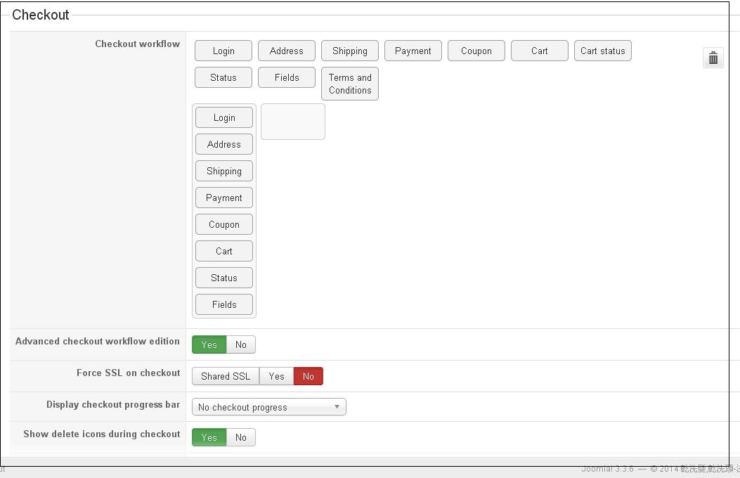

Please give us your checkout workflow settings via a screenshot.

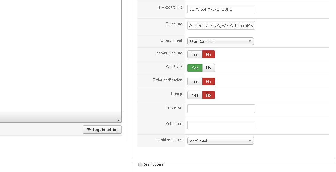

Regarding PayPal Pro, do you have added restrictions on that payment method ?

Hi Xavier, Thanks for your reply.
1 Please see the attachment.
2 No, i didn't add the restriction.

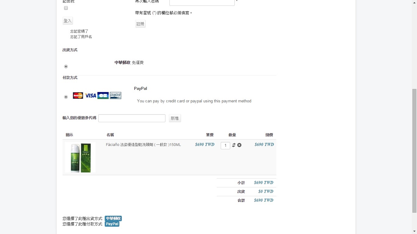

1. I do see a "next" button on your checkout after registering or logging in:
take.ms/g7b5c

I don't read chinese but at the top of your screenshot, I seems that I can see the end of the login/registration form.
So you're not yet logged in or registered, which is why you don't see the "next" button. You first need to login or register and then you'll see the "next" button at the bottom.
