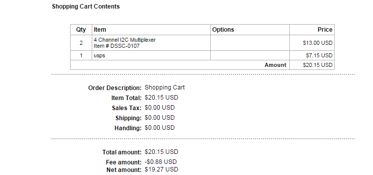

Do any of the Paypal plugins correctly transfer the Shipping and Handling field to Paypal? Currently what I see is the shipping option (usps) and amount transferred to Paypal as a separate line item in the shopping cart. As you can see in the picture the Shipping and/or Handling field(s) are blank.
This really wreaks havoc when I export the order from Paypal to ShipStation on international orders. The reason being is the shipping line item shows up on the customs form as merchandise because it was not originally in the SHipping field in Paypal.
Any help on this issue would be greatly appreciated.

We do that because PayPal doesn't support taxes on the shipping fees and HikaShop does. So we have to put the shipping fees as a product line, otherwise, we wouldn't be able to add the tax on the shipping and the total would be wrong and it wouldn't work.
What you can do is change the code:
$vars['item_name_' . $i] = JText::_('HIKASHOP_SHIPPING');
				$vars['amount_' . $i] = round($order->order_shipping_price - @$order->order_shipping_tax, (int)$this->currency->currency_locale['int_frac_digits']);
				$tax += round($order->order_shipping_tax, (int)$this->currency->currency_locale['int_frac_digits']);
				$vars['quantity_' . $i] = 1;
				$i++;
to:
$vars['shipping'] = round($order->order_shipping_price, (int)$this->currency->currency_locale['int_frac_digits']);
in the file plugins/hikashoppayment/paypal/paypal.php
However, that means that if you have taxes on shipping, it will probably not work properly.
