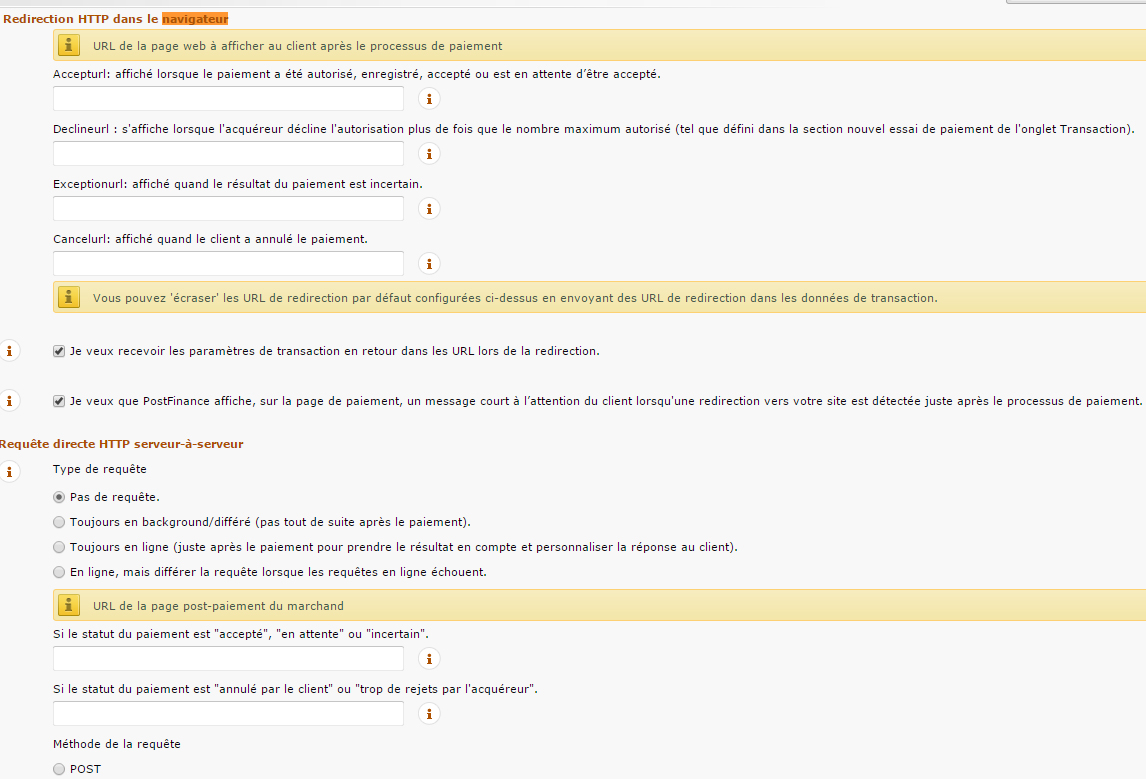

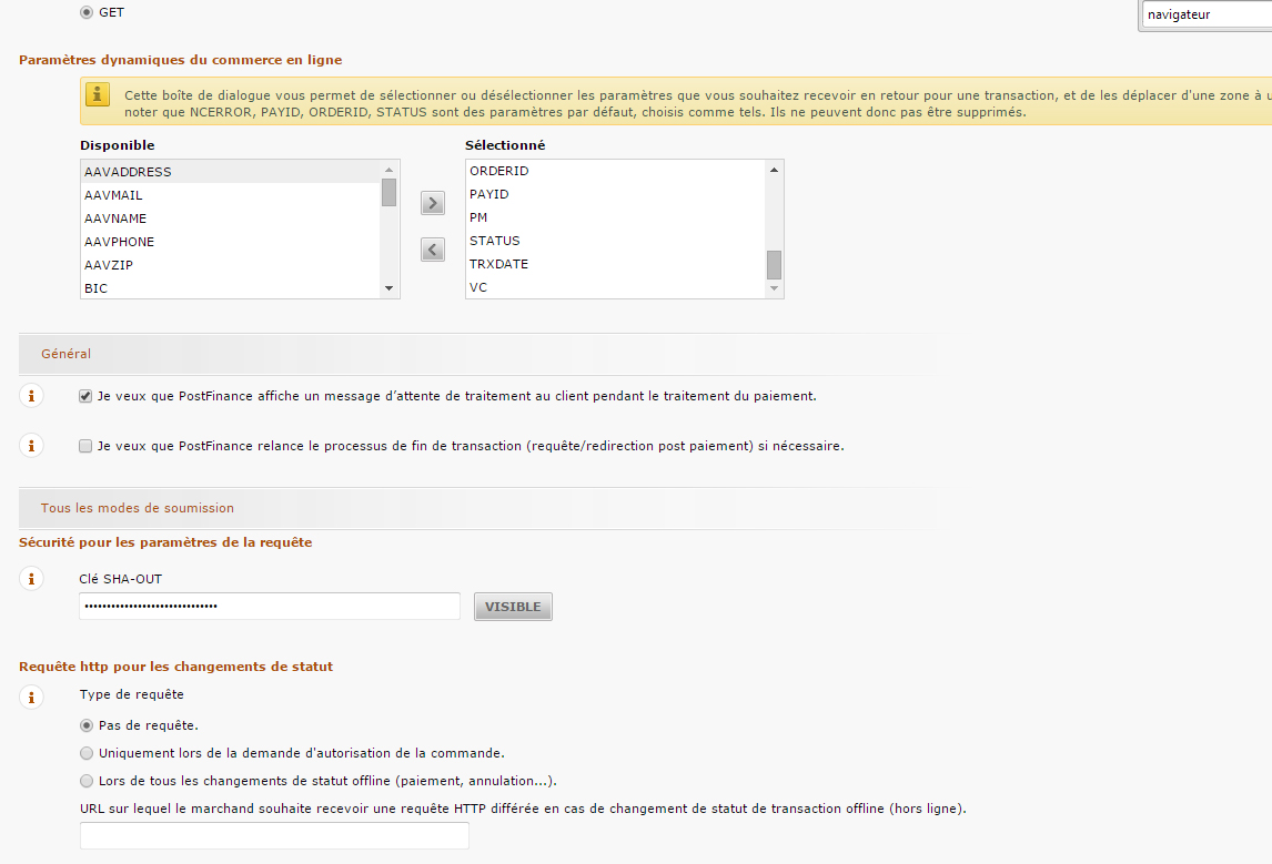

Thank you for your response. I've checked in the configuration, but I'm note sure what I must change.
I send you an image with my actual configuration.
Thank you for your help
11 years 7 months ago #190359
Firstly can you :
- set the "méthode de la requête" option to POST
- download the last Hikashop version through our website and test it again ?
If it still not working, can you please :
- Check that the debug mode option is ON through your PostFinance payment configuration page
- Test it again
- Show me your Payment log file content.
You'll be able to check your payment log file through "Hikashop->System->Configuration->Main" by using the "See the report" button of your Payment log file option.

  • Posts: 8
11 years 5 months ago #197308
did you found a solution ? I've just installed HikaShop with Postfinance payment and I have the same blank page after the payment.

11 years 5 months ago #198073
With the PostFinance account that you gave me I can't edit your PostFinance configuration, but can you check the "I would like to receive transaction feedback parameters on the redirection URLs." option of the "Transaction feedback" tab of your PostFinance configuration and test it again ?
If you still have that issue can you give me a better access to your PostFinance configuration space ?
Thanks.

  • Posts: 8
11 years 5 months ago #198231
Many thanks Mohamed, it works now !
