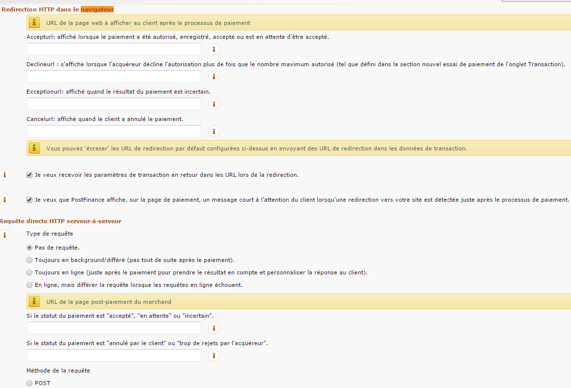

11 years 5 months ago #188727
Hello Mathieu,
As I said through the thread that you checked, I changed these options through his PostFinance account :
- "HTTP redirection in the browser"
- "I would like to receive transaction feedback parameters on the redirection URLs."
you should check it.

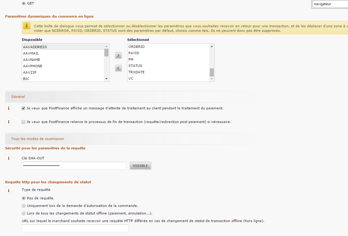

11 years 5 months ago #190342
Thank you for your response. I've checked in the configuration, but I'm note sure what I must change.
I send you an image with my actual configuration.
Thank you for your help

11 years 3 months ago #198073
With the PostFinance account that you gave me I can't edit your PostFinance configuration, but can you check the "I would like to receive transaction feedback parameters on the redirection URLs." option of the "Transaction feedback" tab of your PostFinance configuration and test it again ?
If you still have that issue can you give me a better access to your PostFinance configuration space ?
Thanks.
The following user(s) said Thank You: BObo
  • Posts: 8
11 years 3 months ago #198231
Many thanks Mohamed, it works now !
