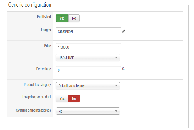

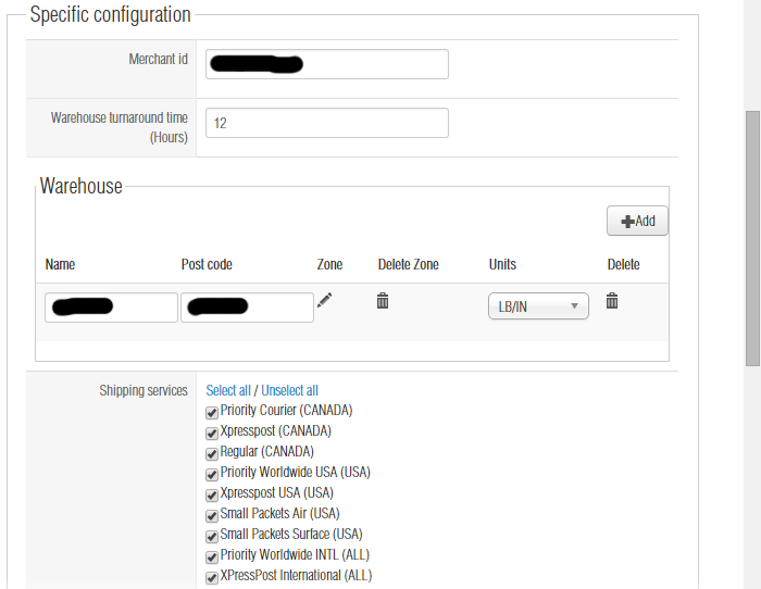

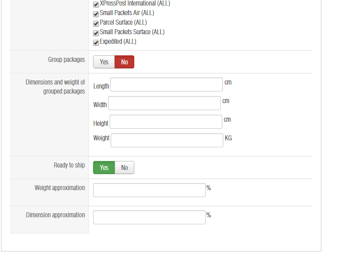

Can you show me how did you configured your Canada Post shipping method through some screenshots ?
Thanks.
  • Posts: 96
11 years 7 months ago #191038
Absolutely here is the configuration
