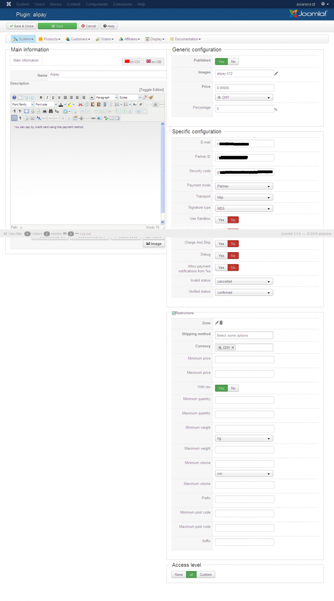

  • Posts: 34
11 years 5 months ago #191236
Please find the attached image showing Alipay configuration .
Jag
11 years 5 months ago #191288
The alipay payment method can't handle the "partner" mode for the moment, you should use the "direct" mode.

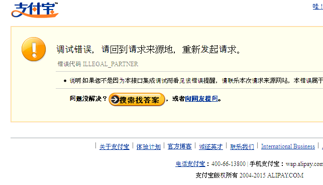

10 years 8 months ago #218920
Client has got ICP licence for their website, Alipay is configured to use "Direct Method" but still we get error message as ILLEGAL PARTNER when checkout is redirected to Alipay Website
Please advise
Jag
10 years 8 months ago #218928
Hello Jag,
Did you contact Alipay about it ?
