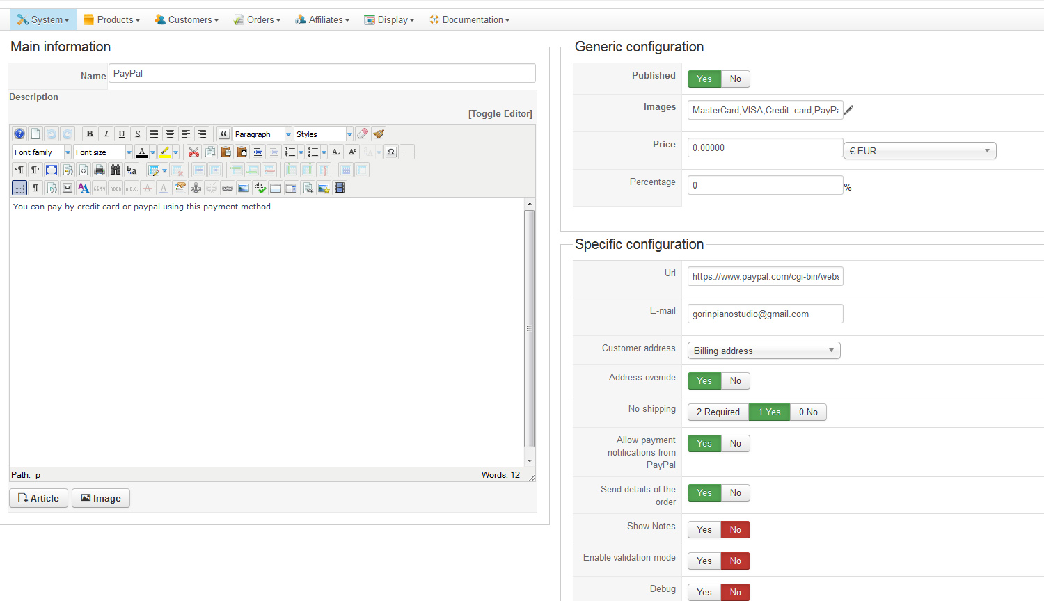

I have a problem with the Paypal-payment method. :(
The shop works fine. I have only one payment-method and that is Paypal.

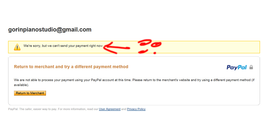

After that the problem start: Paypal cancel the payment and give out an error-message:
"We're sorry, but we can't send your payment right now."
I tried the same from a german Paypal-Account and I have the same problem but it gives me a little bit more information... I translate:
"This invoice is still payed. To get more information, call you dealer."

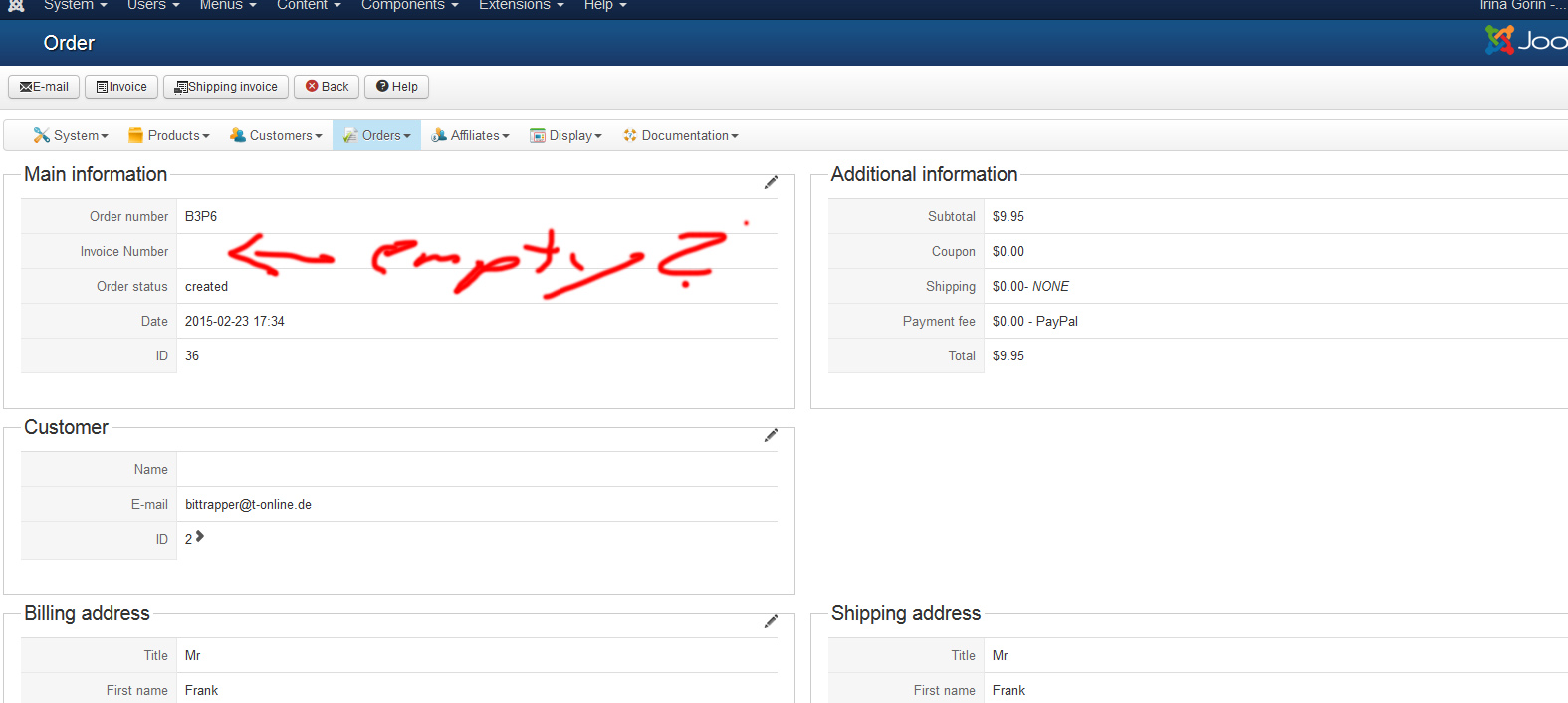

I checked the order-numbers at Hikashop and I wonder that they were all empty. It is only an idea but could this cause the problem? How can I fix it? Do you have another idea?

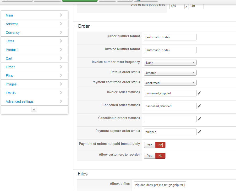

You must have deleted your "Order/Invoice number format" in the system configuration.
See here: www.hikashop.com/support/support/documen...nfig.html#main_order

all these setiings are untouched from me and the settup is "{automatic_code}" - please look at screenshot I uploaded...
I also upload the setting of the Paypal-Module.

I checked online for that error message and all the things I could fine were issues with the PayPal account of the buyer:
ebayquestions.com/2013/03/10/were-sorry-...r-payment-right-now/
Even some buyers buying stuff on Ebay had that error and PayPal is part of Ebay...So it was not related to the merchant account and thus, I don't think it is related to HikaShop.
The invoice numbers are empty in your orders because no payment was made yet for them. By default, an invoice is only created after the payment, so it is normal.
HikaShop always sends the order id to PayPal and that number always exists and is always correct.
So please check your buyer account with the different advices of the link I gave above, and potentially try with another PayPal buyer account.
