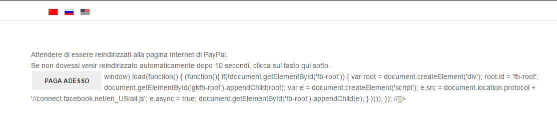

I have tested the paypal plugin on the sandbox.
I have this problem (see image)
If I go on, the order is placed, but I would like to get rid of the error.
Last edit: 11 years 6 months ago by nbstudio.

  • Posts: 86216
  • Thank you received: 14222
11 years 6 months ago #192347
That code issue looks like another extension replacing the HikaShop code there with its own code.
Did you configure any facebook related extension on your website ? If you disable it, does that fix the issue ?
Wheny ou find which extension creates the problem, contact their developer so that they can add an additional check in their code to not replace the HikaShop code.
  • Posts: 40
11 years 6 months ago #192459
hi
no. there's no extension like FB connect or similar.
any other suggestion?
wanna take a look at the site I'm working on?
  • Posts: 86216
11 years 6 months ago #192478
So if you don't have any facebook related extension on your website, where does that facebook code comes from ?
  • Posts: 40
11 years 6 months ago #192510
hi
sorry it was a plugin automatically enabled in the template.
it is the joomla facebook authentication plugin.
I disabled it and the problem disappeared.
Anyway, in case I want to use that, how can this conflict be solved?
  • Posts: 86216
11 years 6 months ago #192515
If it's something coming from your Joomla template, you'll have to contact your template provider so that they can fix the code of the template in order to not replace code on that page of your website.
