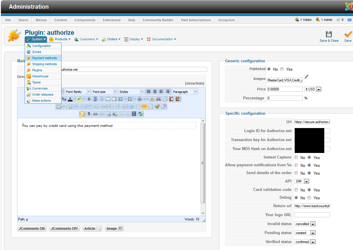

I'm getting an error after payment with Authorize.net. Where I should see a 'Thank you for you purchase' I just get a white page with 'Invalid Notification' in the system-message-container.
This does not happen with the PayPal plugin so me thinks that the AN plugin isn't understanding the transaction notification.
BTW, the transactions do go through and AN is collecting the money although orders in HS have never showed anything but canceled for as long as we've used it..
I'm attaching a screen capture of the AN Plugin page - perhaps I've set it up wrong?

Your Authorize.net seems to be correctly configured, can you :
- Check that the debug mode option is ON through your Authorize.net payment configuration page
- Test it again
- Show me your Payment log file content.
You'll be able to check your payment log file through "Hikashop->System->Configuration->Main" by using the "See the report" button of your Payment log file option.

Your issue seems to be coming from the "Your MD5 Hash on Authorize.net" field of your authorize.net payment method.
Can you check it, and try it again ?
