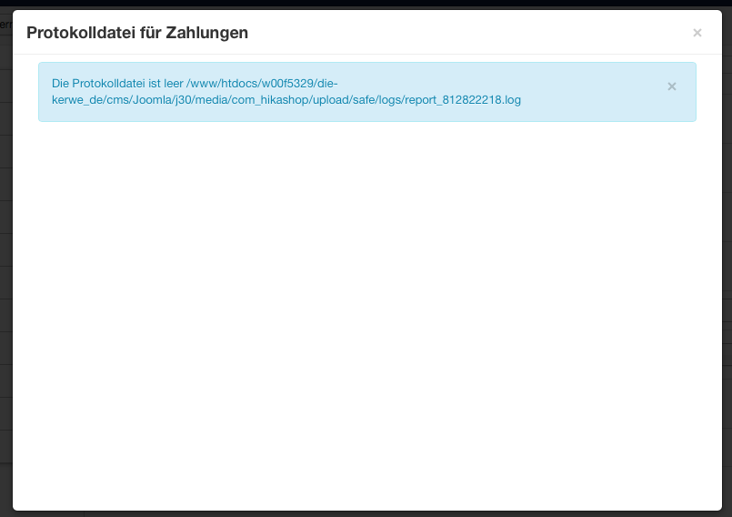

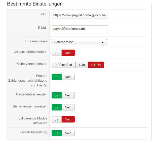

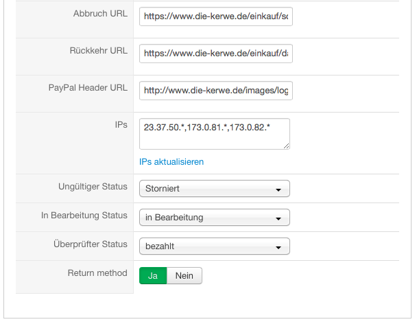

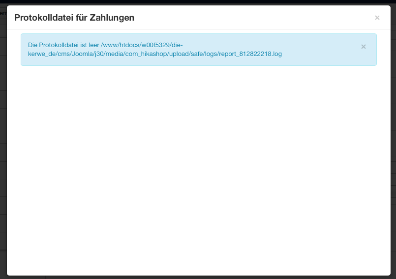

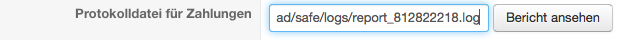

Sorry, I get used to screenshots for this kind of thing.
My report.log file didn't exist until I created it manually with the file name of the components configuration. According to Joomlas system information the file should be writable.
The HikaShop payment log is only available from the HikaShop configuration backend, it has a very specific name and the folder where this file is stored by default is not managed or listed in the Joomla system information screen.
So, I'm afraid that we will need screenshots to be sure what you are currently performing with the HikaShop payment log.
  • Posts: 16
11 years 5 months ago #198229
You're right, I'm sorry! So here are the relating screenshots. Maybe you could add a "Is the report directory / file writable?" feature like Joomlas system information to ensure the permissions are correctly configured?

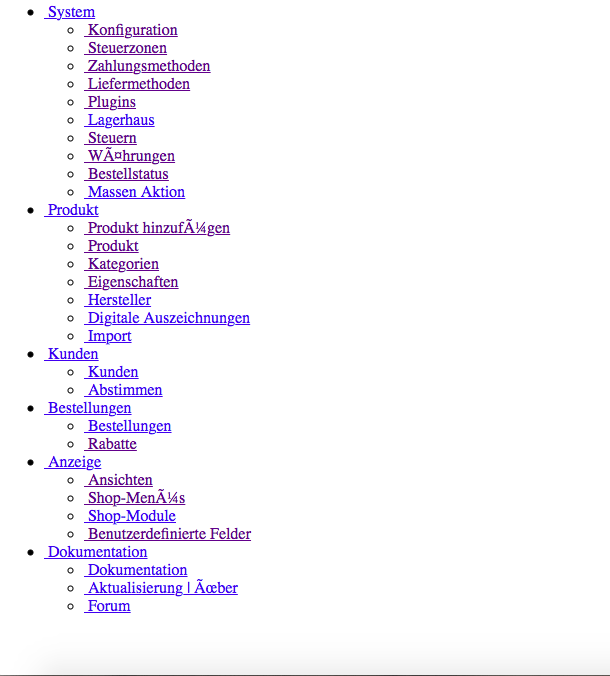

Hello!

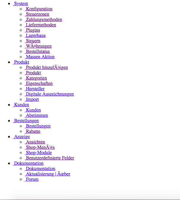

I tried the replacing but no change. Neither was anything written to the file nor did I get any error messages. BUT:
With using this code
function onPaymentConfiguration(&$element) {
$this->writeToLog( 'test' );
I'm getting a almost blank page with the menu of HikaShop so I don't come onto the configuration page of the plugin (see attachment).
So I tried to add the code above into the existing onPaymentConfiguration function but also no change of the report.log file (but at least I came onto the plugins configuration page).
After this I tried to manually write anything to the report.log file (via FTP) and view it via "configuration/files/view report" and it was still empty. Even after commenting out "deny from all" just to be sure it's not due to access restriction.
  • Posts: 26387
  • Thank you received: 4078
11 years 5 months ago #198433
You should have a PHP fatal error ; please check your PHP error log.
