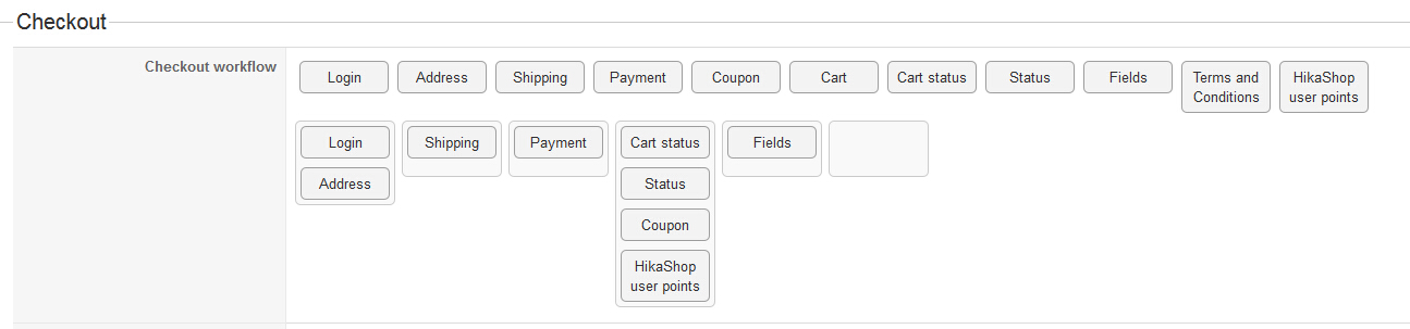

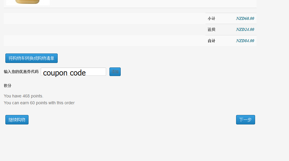

Hi Hikashop team,
When I setup the hikashop user points, it dosen't show in the frontend when check out, I attached some screenshop, could you please show me where should I change?
Thanks!

First please update to HikaShop 2.4.0.
Then edit the plugin "plugins/hikashop/userpoints/userpoints.php" and replace
if($mode == 'hk') {
	if(isset($user->user_points))
		return (int)$user->user_points;
	return false;
if(isset($user->user_points)) {
	if($mode == 'all')
		$ret['hk'] = (int)$user->user_points;
	else
		$ret = (int)$user->user_points;
By
if($mode == 'hk') {
	if(isset($user->user_points) || in_array('user_points', array_keys(get_object_vars($user))))
		return (int)@$user->user_points;
	return false;
if(isset($user->user_points) || in_array('user_points', array_keys(get_object_vars($user)))) {
	if($mode == 'all')
		$ret['hk'] = (int)@$user->user_points;
	else
		$ret = (int)@$user->user_points;
And it will force the display of the checkout user points blocks even if the user does not have any points yet.

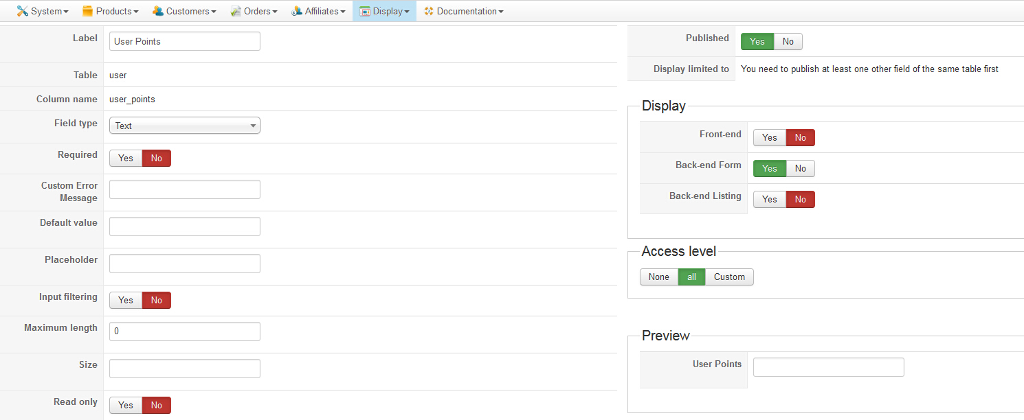

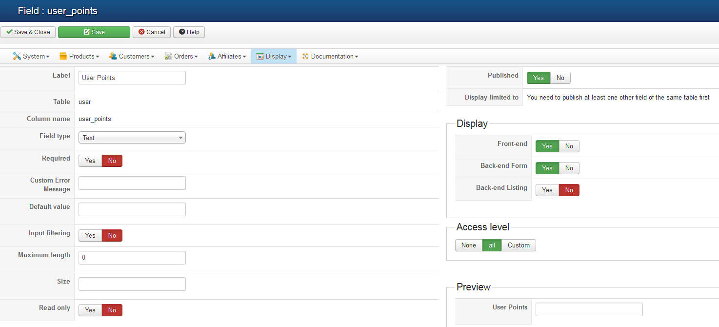

You should also change the configuration of the "user_points" custom field to not display it in the front-end ; otherwise the user will be able to modify his points himself and I don't think that you want to allow that.

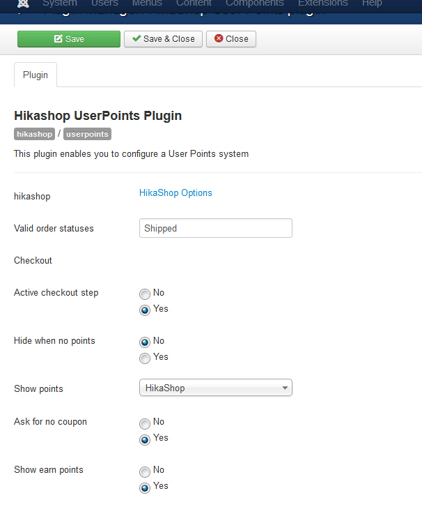

About the configuration of the Joomla plugin, you specify a order status ; which is good if you do not want to use the values from the HikaShop "invoice order statuses" setting ; but I see that you put an order status with an uppercase and that's not the exact order status namekey. We will see to improve the interface in the Joomla plugin configuration in order to use a namebox, before that, please use instead
shipped

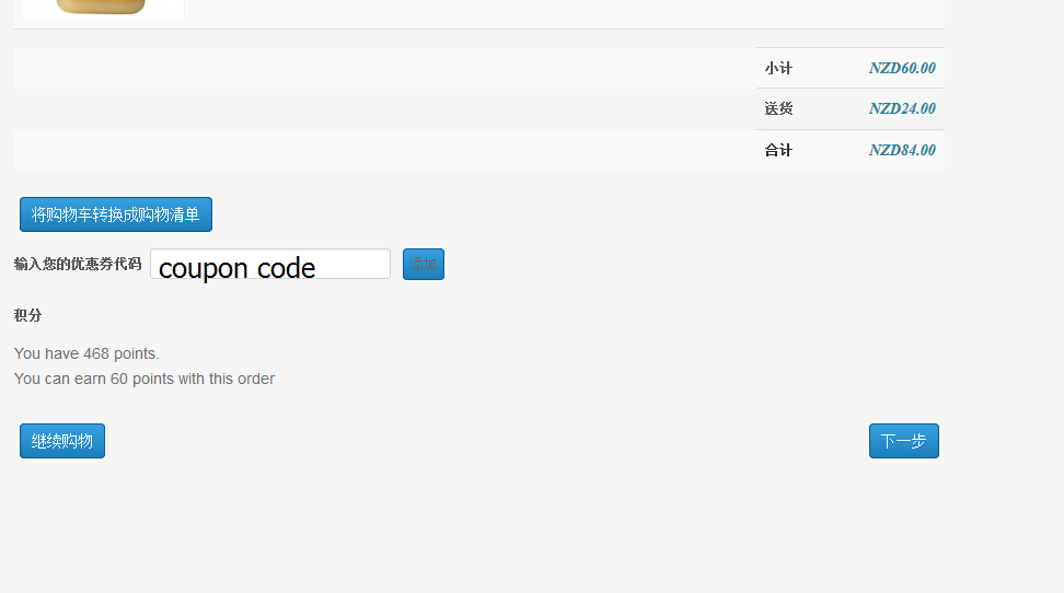

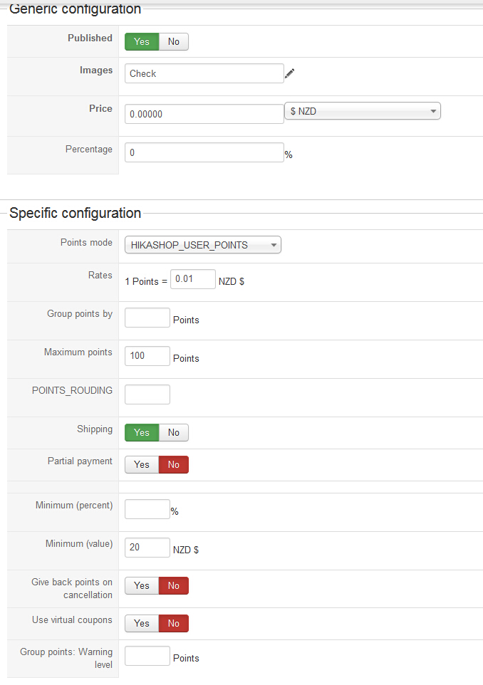

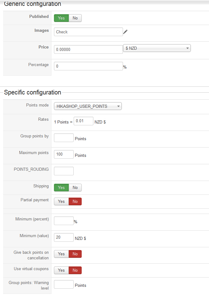

11 years 4 months ago #201920

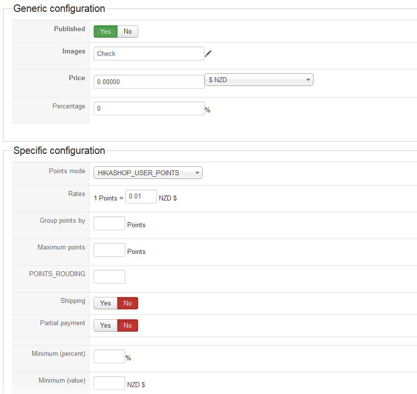

Thank you very much, I upgraded hikashop and changed the code, now the user points earning displays in front end but the payment dosen't show. Could you please have a quick look at my configuration?
Thanks!

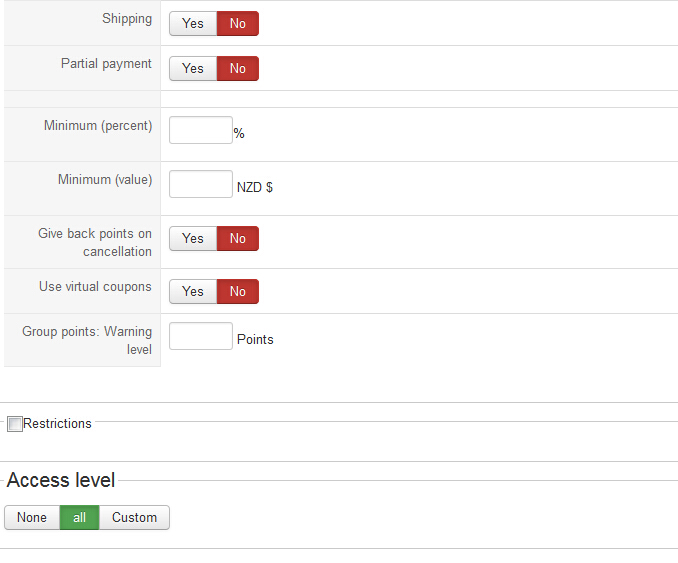

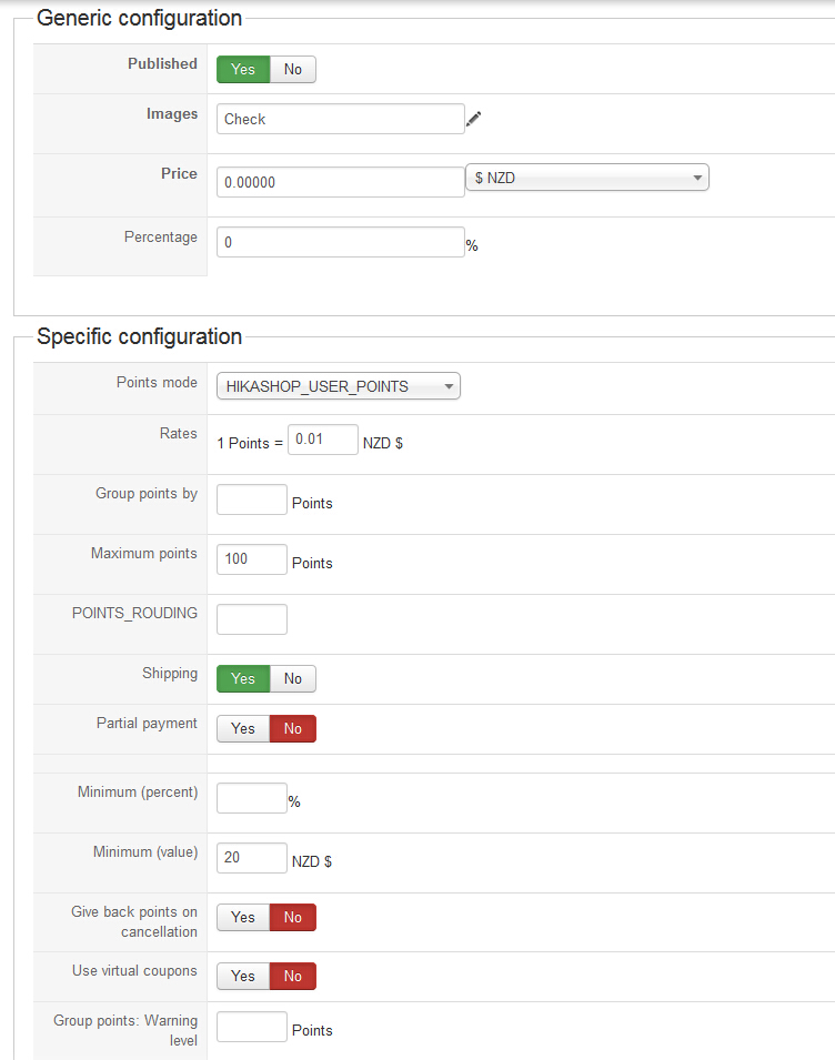

11 years 4 months ago #201921
You do not authorize the "partial payment" which means that you need to have 6000 points to be able to pay the order using points ; and regarding your screenshot, you have just 468 points.
So I recommend you to activate the "partial payment" if you want to use your 468 to create a "NZD 4,68" discount.
You can also use the "virtual coupon" mode to have a different approach of the points and not decide to use them by selecting a payment method.
