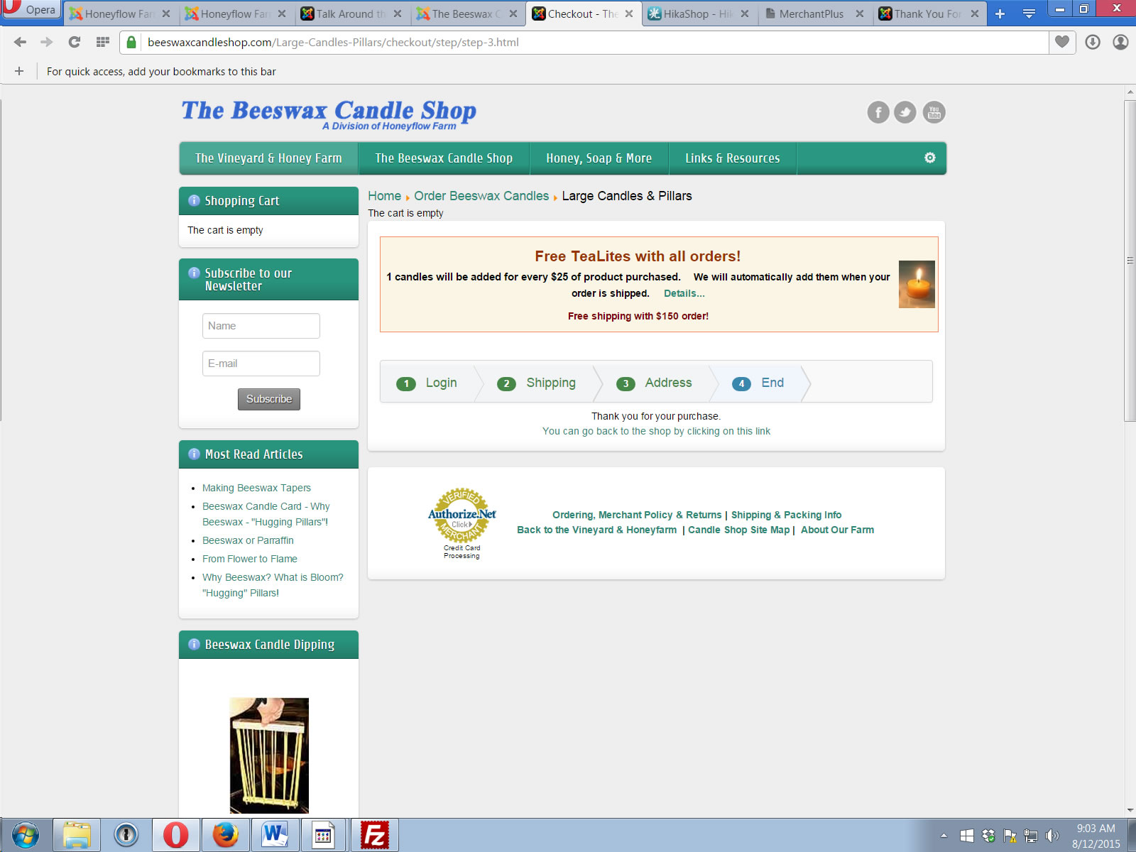

The only small problem left is the program does not go to the final page automatically (image below) unless you click on it. (I do have the correct return url entered)
  • Posts: 26376
10 years 11 months ago #211375
The page you got is the "thank you" page of the Authorize.net plugin ; and that page does not have any script to automatically redirect the user.
If you want to customize the page, you can perform a manual override of the plugin view.
If you want to use another "thank you" page, you can configure the "return url" of your authorize.net plugin.
