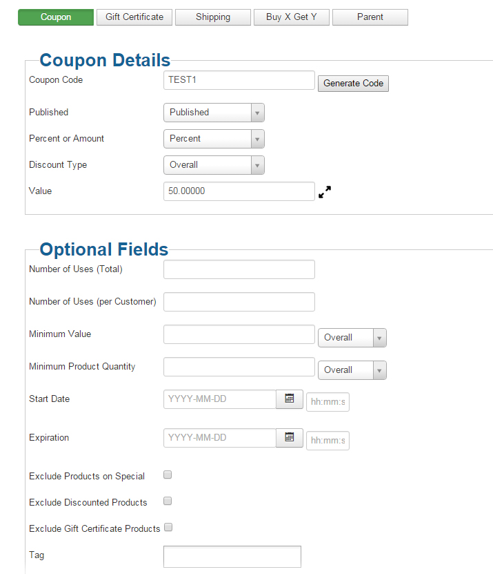

The minimum has to be 50€ for normal users (a minimum set in the CM CIC paiement plugin), but I would like to have a minimum of 25€ for an other type of client who's got a coupon, for what I am using Awo Coupon Pro.
The minimum order set in Awo Coupon Pro can't override the minimum set in the CM CIC paiement plugin.

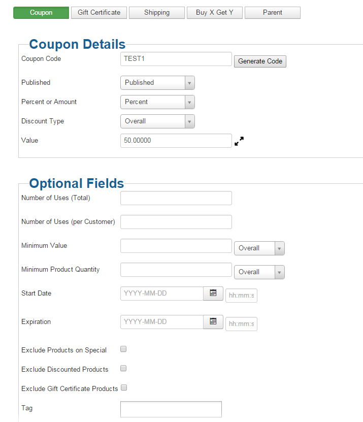

We can set a different one with Awo Coupon Pro (as on the image linked)
But this one can be smaller than the first one.

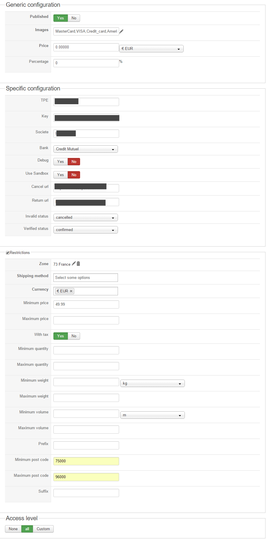

You can do that by creating several payment methods for your payment plugin via the "new" button of the System>Payment methods menu and then, in each one you can use the minimum post code and maximum post code settings in order to define the range of the post codes for that particular payment method and then configure the "minimum price" setting corresponding to the range of the post codes that you configured.

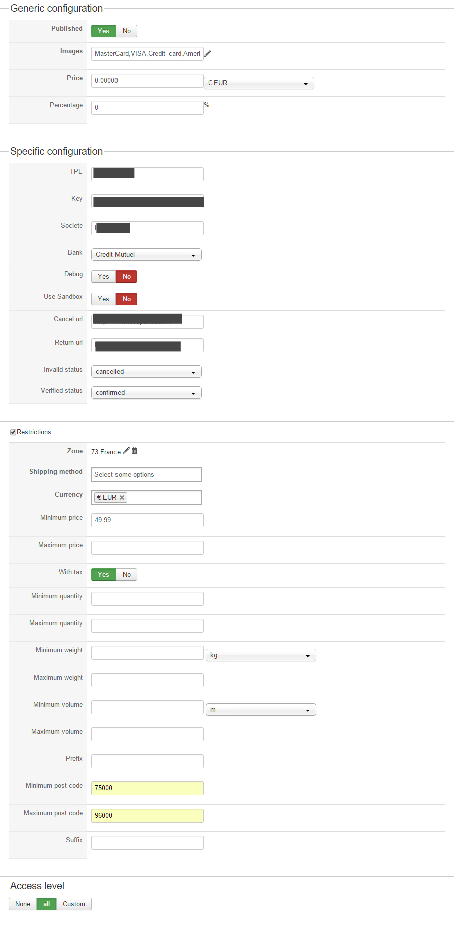

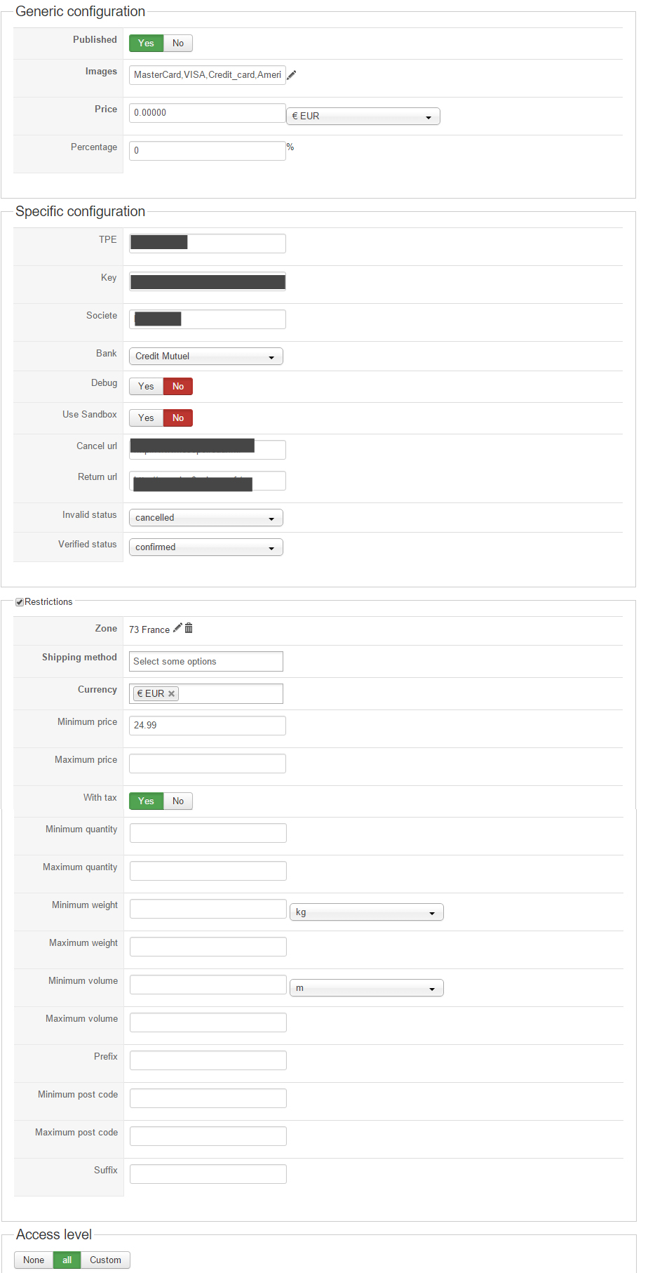

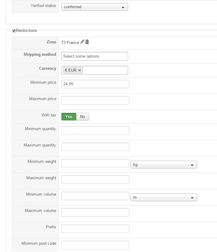

10 years 10 months ago #213652

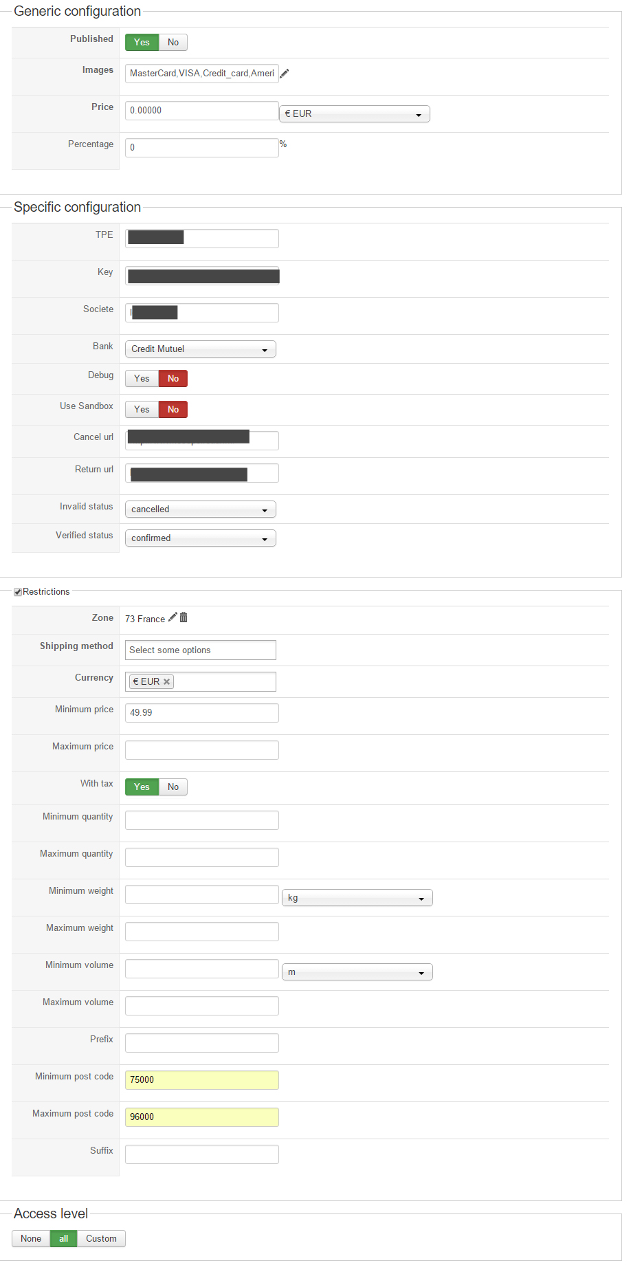

The first one, with a minimum of 49.99€: for customers living in zip codes from 75000 to 96000, which is not working

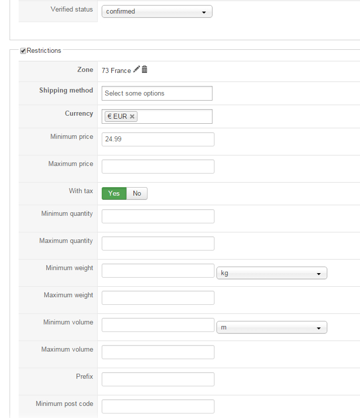

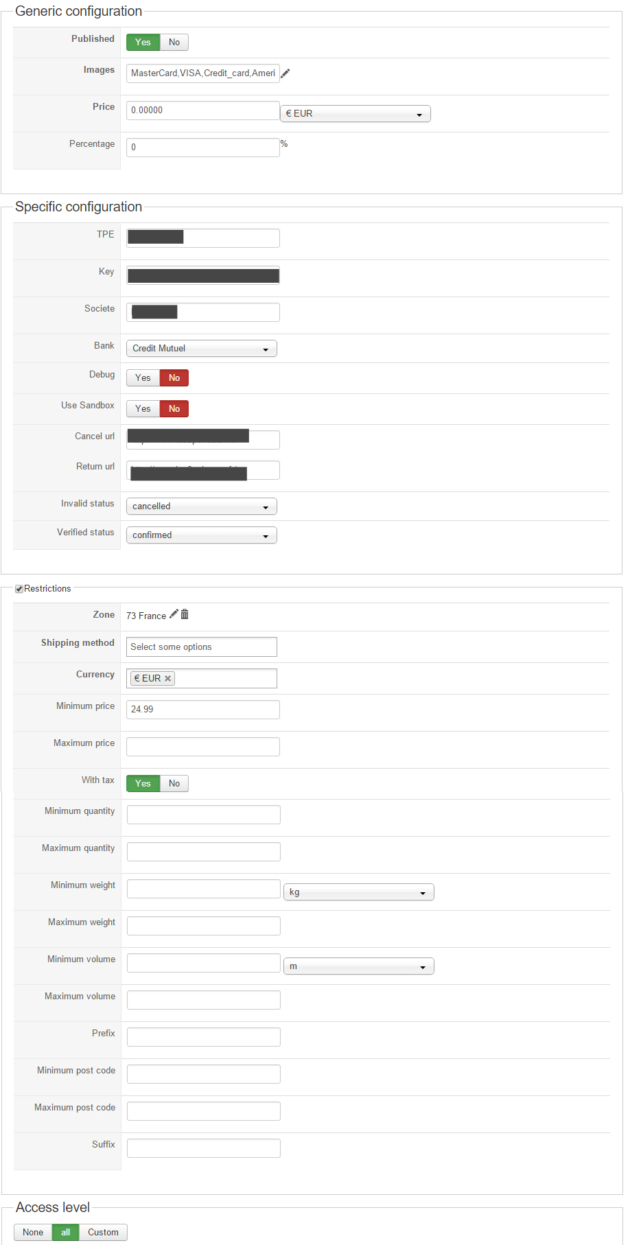

The second, with a minimum of 24.99€: for specials customers without zip code, which is working
Whatever I put in one the zip code fields, the payment method will not be working. It's seems that the plugin doesn't identify any zip code in the profile of the user
  • Posts: 85952
  • Thank you received: 14143
10 years 10 months ago #213723
The settings mean that the payment method will only display if your address post code is between 75000 and 96000 ( what post code did you use for your tests? ), and if the total amount of the order is above 49.99 EUR (is that the case ?), and if the country selected in the address is France and if the current currency is EUR.
In all the other cases, it won't display. So I can only assume that one of the conditions isn't met for the payment method to display.
Remove the restrictions one by one and see which one causes the problem.
If it really comes from the post code, please provide a screenshot of the address form where you entered your address and a screenshot of the listing of custom fields in your backend.
