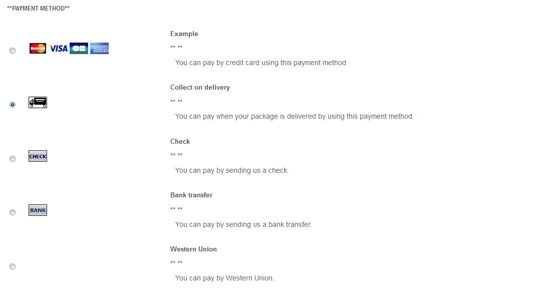

-- HikaShop version -- : 2.5.5
-- Joomla version -- : 3.5
-- PHP version -- : 3.5
-- Browser(s) name and version -- : firefox-latest

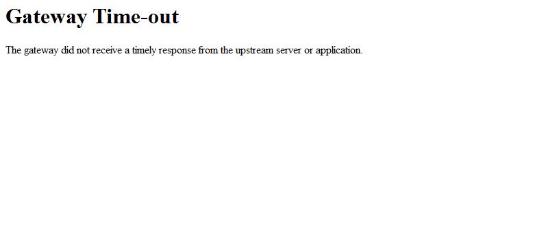

-- Error-message(debug-mod must be tuned on) -- : When checking out i have CollectionOnDelivery, Check Payment, BankTransfer all are giving "Gateway Timeout".
So NOT ERROR MESSAGE SEEN
User: test
Password: test
User: test
Password: test

It looks like the problem comes from the creation of the order itself, not the selection of the payment method.
If you remove the "payment" view from your "checkout workflow" I would guess that you still get the same error.
Do you confirm ?
If so, there is a high chance that it comes from the sending of the email which takes too much time (maybe the website is not able to contact the email server you configured (or have configured) on your server and waits the timeout period of 60 seconds) compared to the allowed processing time of your web server's watchdog, or something like that.
  • Posts: 2
10 years 11 months ago #211731
Yes, u are right. Even after removing the payment from checkout workflow, i am getting the same error.
Seems like i haven't configured the mailing system. Can you please help me in that.
  • Posts: 85952
  • Thank you received: 14143
10 years 11 months ago #211744
The configuration of the email settings will depend on the recommendations of your system administrator or hosting company.
As we don't know them we can't tell you what to put where. You should seek advice with your system administrator or hosting company.
