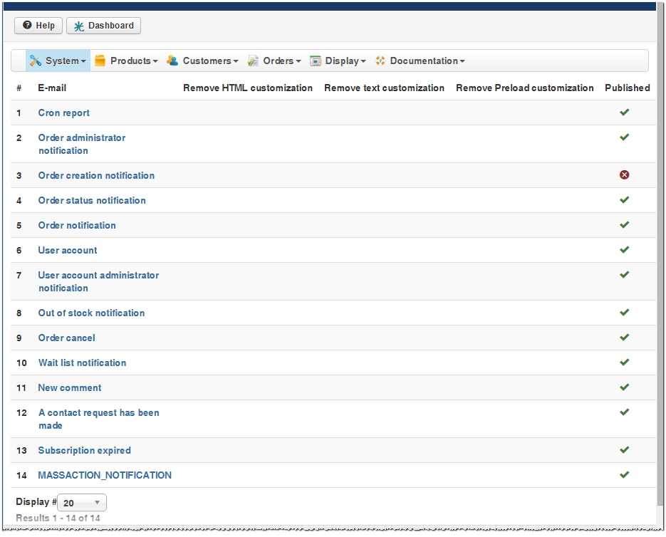

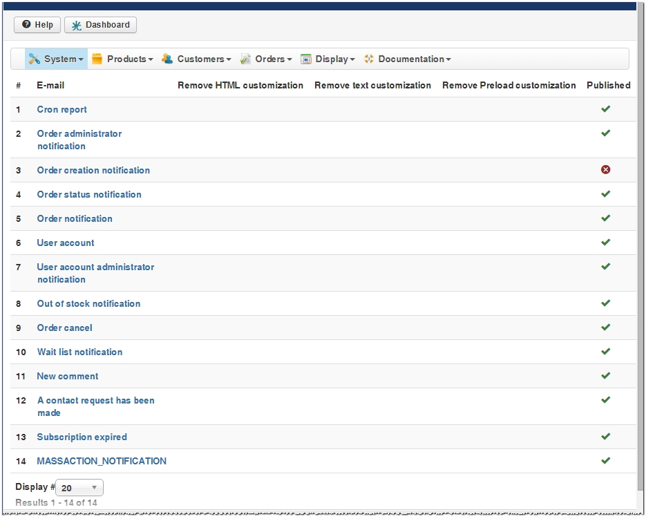

In the e-mail logs I see an order create email was sent, that arrives just fine but the order confirmation e-mail is never sent and the order status is never set to "complete"

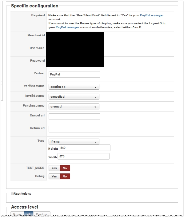

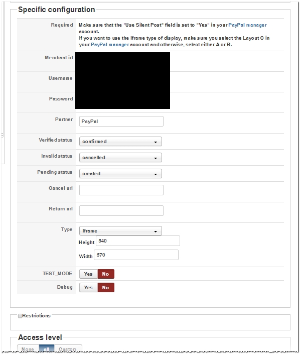

Debug mode seems to do nothing even though I've used it before, there's NEVER been a log created.. there wasn't even a log folder where the "files" tab said it should be.

There are zero e-mail customizations done, all e-mail plugins are active except the order creation plugin, but that was disabled days ago and it was working just fine.
Creation e-mails work fine, Joomla system e-mails work just fine, no errors in the mail logs whatsoever, no errors in apache logs, no errors on the screen and no debug file to speak of.

The issue was not with Hikashop, Apache or anything like that .. it's actually a PayPal Payflow issue and it's inability to communicate with certain SSL certificates.
Because our site was set up to force SSL it was causing HikaShop to put https:// on the silent post url, which honestly wouldn't matter anyway because the paypaladvanced_#_whatever.php includes index.php at the end so Joomla redirects to SSL before the post can complete.
I had to disable SSL on the front-end and just have it set to forced on checkout for HikaShop.
