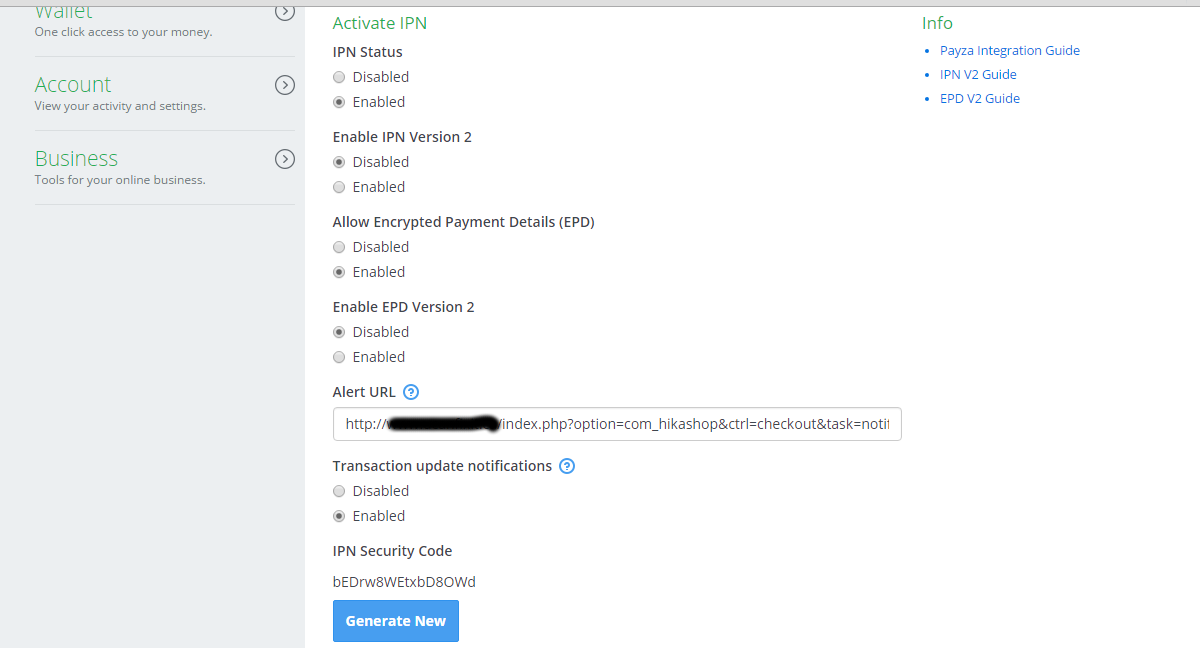

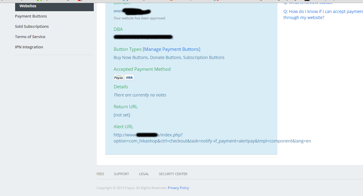

Ok thank you for your help. I have attached a couple imges of the payza side of things. can you please tell me what needs to be set to what??

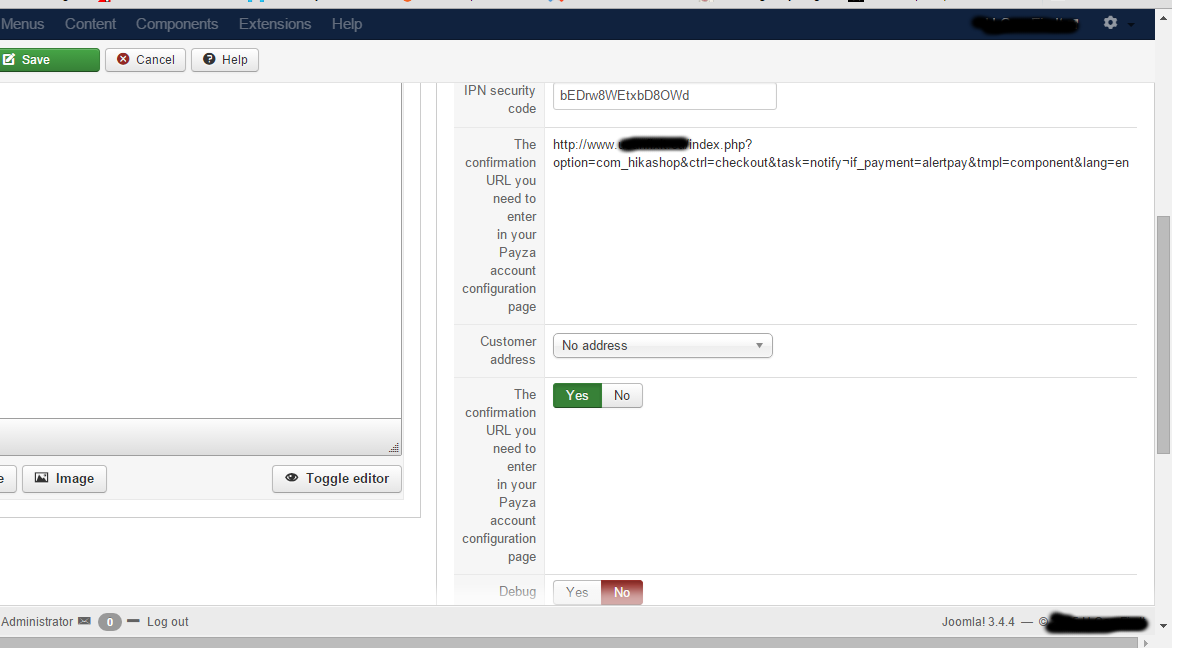

10 years 10 months ago #214041
hikashop side:

10 years 10 months ago #214047
Make sure that the URL in your payza account has that text:
&task=notify&notif_payment
and not the text:
&task=notify¬if_payment
The following user(s) said Thank You: ucan
  • Posts: 21
10 years 10 months ago #214063
Thank you!!!!! that fixed the problem.

  • Posts: 85952
  • Thank you received: 14143
10 years 10 months ago #214068
That's because your browser converted the
&not
to that character even though it should only do that for
We'll modify the plugin interface to avoid that in the future.
