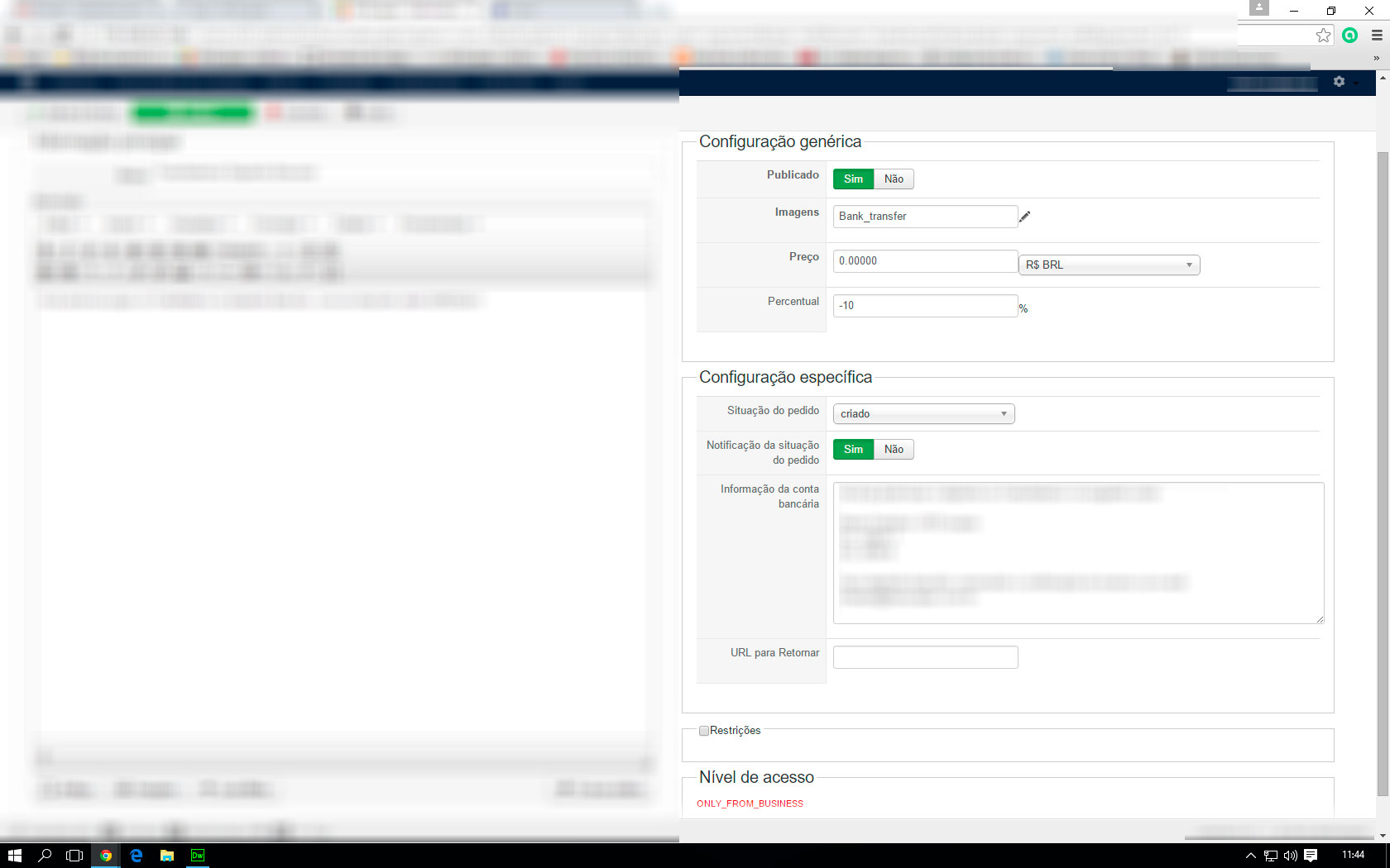

One of the payment methods (Bank transfer) in my website has a discount of 10 % on the value of the product ,
the problem is that it also calculates the discount upon the delivery value , how can I solve this problem ?

10 years 10 months ago #215132
Yes , I am sending attached a screenshot.
Use the percentage option to apply the discount should apply to all products from the site , if the customer choose this method of payment.

10 years 10 months ago #215167
Well, using the payment fee as a discount is already border line, so there is no mechanism to have it apply to only the products and not the shipping fee.
