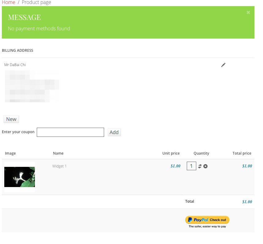

2. PayPal Express
When I click on the PayPal Express button, nothing happens, meaning, I am not taken to PayPal. Instead, the screen refreshes and then it goes back to the page where the PayPal button was clicked.

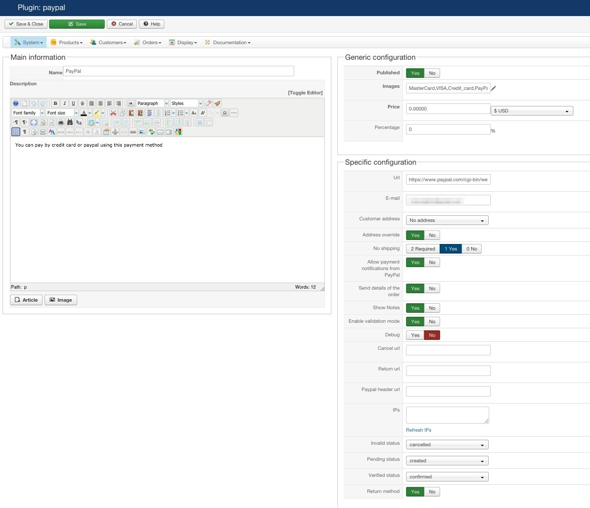

10 years 11 months ago #215081
Can you show us some screenshots of how you configured your payment methods and your checkout workflow via "Hikashop->System->Configuration->Checkout" ?
Thanks.
  • Posts: 5
10 years 11 months ago #215173
Per your request. Enclosed pls find screen shots of various pertinent settings.
Thank yo for your help!

10 years 11 months ago #215371
For "paypal", please deactivate the setting "send details of the cart".
For more details, please see : www.hikashop.com/support/documentation/i...nt-paypal-error.html

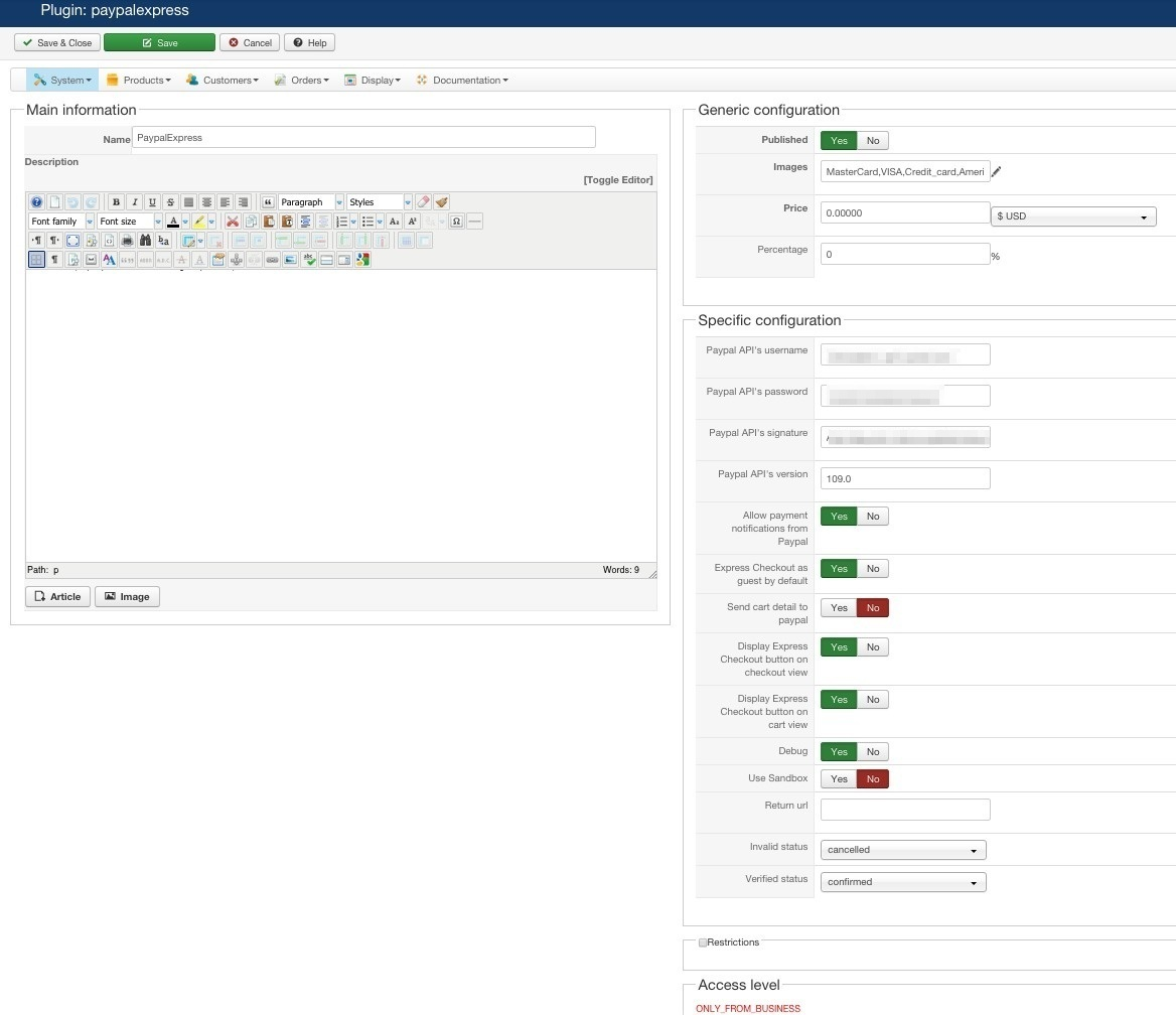

  • Posts: 86087
  • Thank you received: 14194
10 years 11 months ago #215634
HTTPS is not necessary.
The error
Connection failure - error code: 10525, error message: This transaction cannot be processed. The amount to be charged is zero.
is not a HikaShop error. That's a PayPal error. If PayPal displays that, it means that it believes that the total amount of the order is 0.
Could you do a screenshot of the settings of your PayPal express payment method ? (please blur sensitive data)
