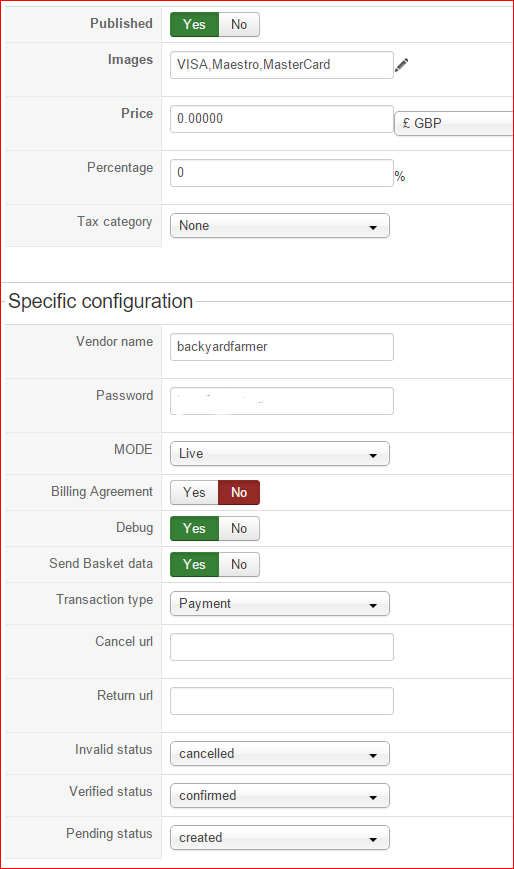

Please edit your SagePay plugin configuration and re-save it.
If the problem persist, we will require a screenshot of your configuration (where you can remove/hide your credentials).

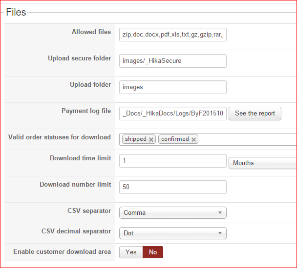

I can appreciate the TX code refusal from Sage Pay as it's likely that the same code is sent when I try to repeat the order given that the initial order is not completed successfully - the transaction status in Hika shop doesn't change from "created" to "confirmed". I presume that once the token from SagePay is received; Hika makes the change from "created" to "confirmed". This doesn't happen.
Also DEBUG is turned on, but doesn't log any information - any ideas? I've attached the SagePay config section and also the Files config where the Debug Log file is defined.

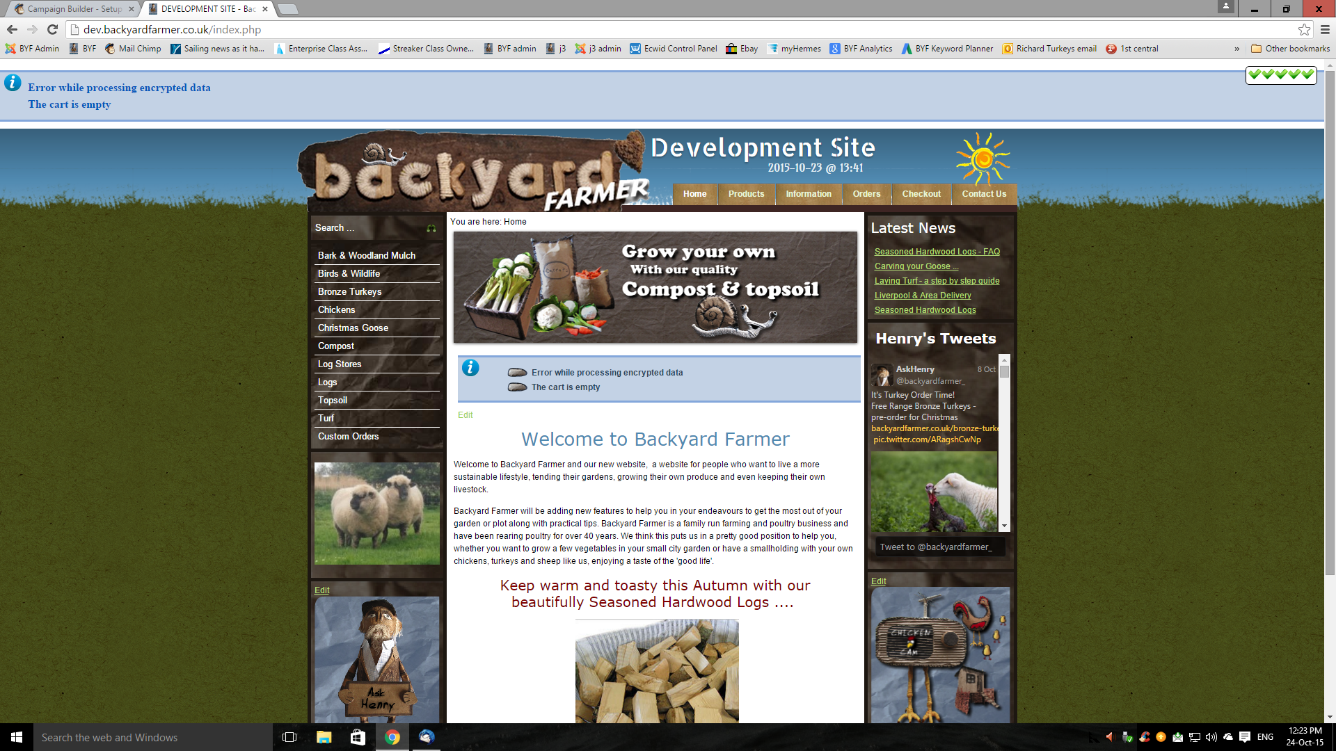

Reinstalled Business v2.6.0 on DEV site, Ran a test purchase, still getting no confirmation change from SagePay (Created not changed to Confirmed)
1st try it went to Malformed.
2nd try, Cleared settings etc and next order went through to sagepay, payment went through, no email, no change on administrator and error showing as customer below: ByF2015-10-24#1
Any suggestions as to what's wrong and where to fix?
