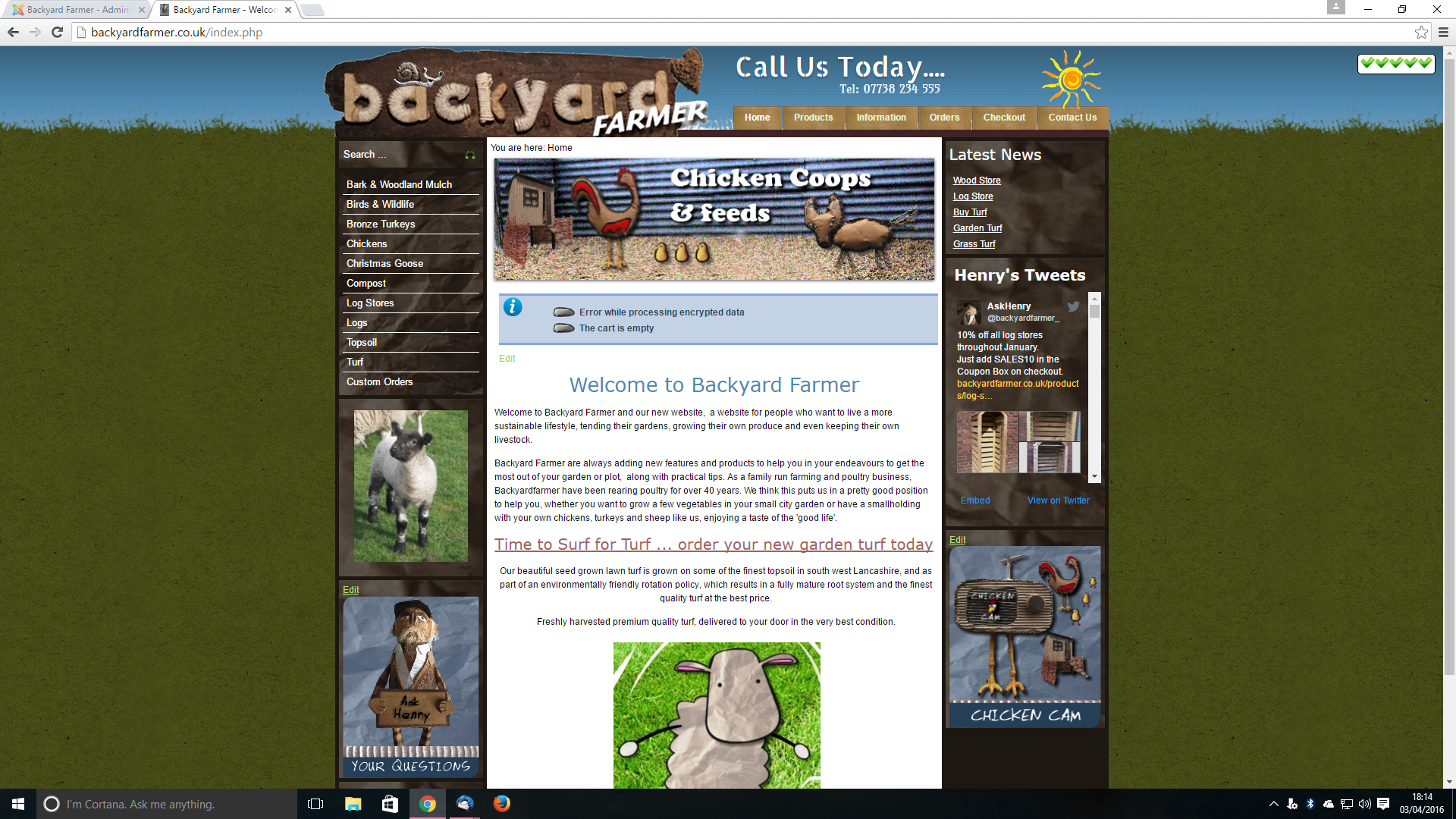

I have just done a test payment for £1 custom order VIA SAGEPAY and payment went through but came up with error message after payment. 'Error while processing encrypted data'
We have had this before, but cannot remember how it was resolved.
Can you suggest where things might be going wrong so that we can get this fixed?
Thanks,
R.
10 years 5 months ago #235371
This indicates that HikaShop wasn't able to decrypt the data sent by SagePay.
Most of the times, the problem is that the "password" configured in the payment method doesn't correspond to the password configured in the sagepay merchant account settings.

Have solved our other issue with a further upgrade, and was hoping this may also have fixed the original problem with Sagepay payments sending error msg 'Error while processing encrypted data' and not updating website or confirmation email.
Have done another test sale and though the same message appears and the admin back end of website still not updated, we are now getting an email from sagepay to say payment confirmed. If we can just rectify the encryption issue we are sorted. Any other ideas or fixes greatly received.
Thankyou
  • Posts: 86216
  • Thank you received: 14222
10 years 5 months ago #237233
The issue with the emails came from your update of Joomla. And updating HikaShop was indeed the solution.
But the issue with SagePay is not linked to that.
As Philip said, this indicates that HikaShop wasn't able to decrypt the data sent by SagePay and that's usually because of the password configured which doesn't match with the one in your merchant account.
We didn't change anything regarding encryption. It still uses the same functions it has since the beginning:
take.ms/uEBLC
And I believe we got them from SagePay's integration documentation when the plugin was first developed.

There is something I don't understand... You say that you have always the encryption error message BUT orders are always AUTOMATICALLY confirmed, right ?
And this is this error message : "Error while processing encrypted data" right ?
If yes, I need to process some tests by myself with an front end and back end access (via our "Contact us" form add an url link to this topic in your message.
Awaiting news from you.
Last edit: 10 years 3 months ago by Philip.
  • Posts: 60
10 years 3 months ago #243116
the orders are not automatically confirmed, I have to do it manually. Orders from paypal work ok and are confirmed but with sagepay the payment goes through ok, we get email confirmation from sagepay that the payments is successful, but it does not auto confirm on the back end fthe website and sends the error message "Error while processing encrypted data". Seems strange that it works for paypal not sagepay, so I would assume it is something to do with the sagepay plug in. Nothing has changed as far as sagepay are concerned and it worked fine until the last HIka update.
Apart from that and possibly more important, could you please check the other part of my query which is in red above re the security certificate update - can you please advise that Hikashop is compatable with everything they have mentioned.
Thankyou
  • Posts: 86216
10 years 3 months ago #243139
Thank you, that's clearer.
So you need to edit your SagePay payment method settings and save them once as we changed the way the order confirmation is handled 7 months ago.
That should fix your problem.
