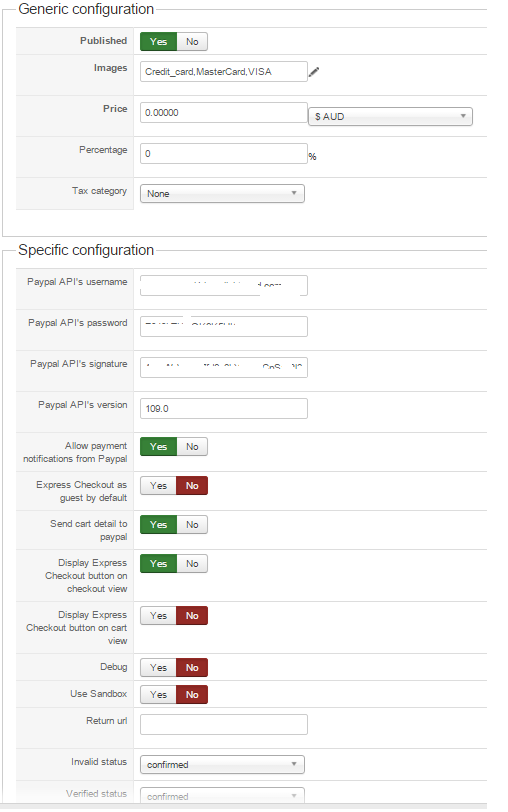

10 years 9 months ago #224084
hello i am also getting issues when with Send cart detail to paypal : Send the detail of the products to paypal
this is not coming up in the paypal details when viewing on paypal what the the user has purchased..on paypal it only displays the
total amount in transaction details..
i have set in the option to send cart detail to paypal..
your help would be appreciated.
  • Posts: 86216
  • Thank you received: 14222
10 years 9 months ago #224110
Can you provide a screenshot of the settings of your PayPal Express payment plugin ? (hidding the confidential information).
  • Posts: 13
10 years 9 months ago #224194
  • Posts: 86216
10 years 9 months ago #224222
It seems correct. Could you provide a link to the shop so that we could analyze the situation ?
