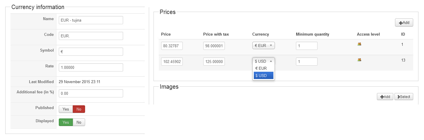

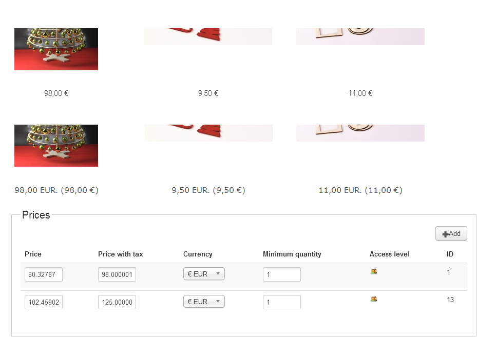

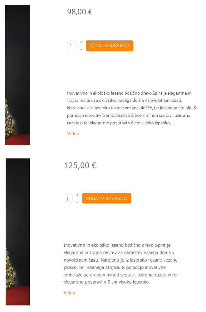

  • Posts: 13
10 years 9 months ago #222673
Sorry for inconvenience caused (my story is presented below) and thank you for your help.
It seems that the entry the second currency is now no longer a problem, but now the problem occurs when showing it. Plugin GoeLocation works perfectly and it recognizes foreign country and shows other currency. However it shows the "original" price (98,00 EUR) instead of second price (125,00 EUR.), which is defined for that currency. See attached pictures (there are two currencies “EUR” and “EUR.”)
Why is also presented the "original" prices in EUR?
I feel that we are close to a final solution :)
My story: I use to be WordPress user, but a half a year ago my friend came to me with Akeeba backup to restore his shop and put it on our servers. Shop was placed on our server and everything worked perfectly. About 14 days ago he came to me with a desire to make his boutique store also presented abroad, where prices will be slightly different. Most of the knowhow I got on your excellent forum, but when I faced with a “bigger” problem, I simply started a new forum topic.
Thx
Last edit: 10 years 9 months ago by elenora.

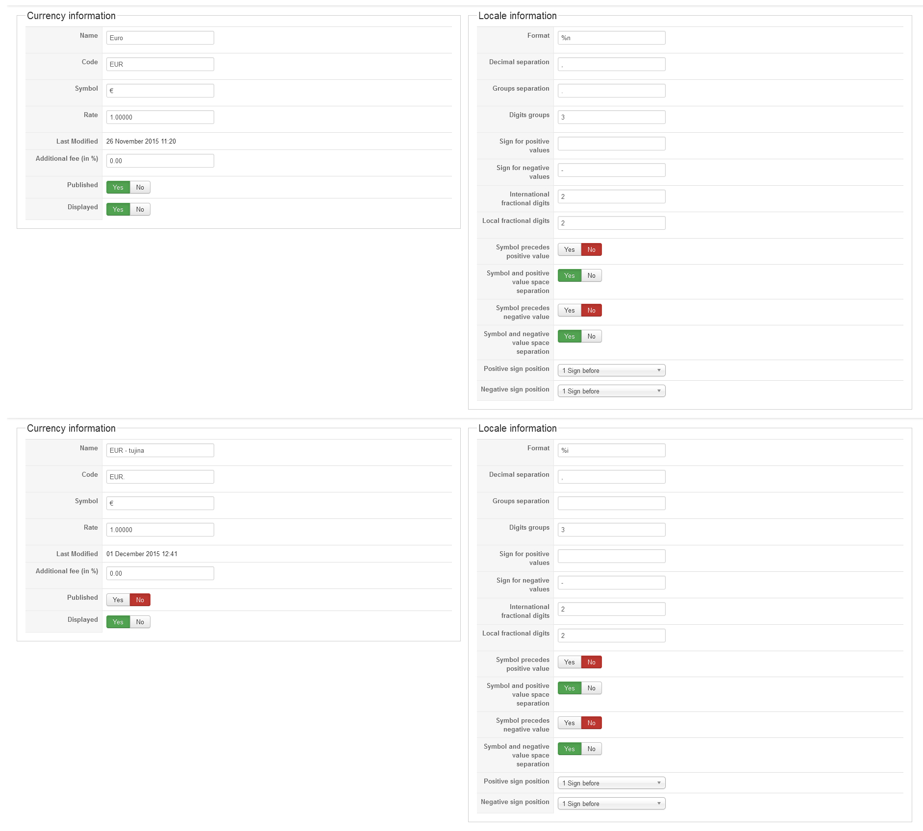

10 years 9 months ago #222687
Could you provide a screenshot of the settings of both the EUR and your currency so that we can see how you set them up ?
Which version of HikaShop are you using ?
  • Posts: 13
10 years 9 months ago #222767
Is this the screens you are looking for?
* @package HikaShop for Joomla!
* @version 2.3.0
* @author hikashop.com
* @copyright (C) 2010-2014 HIKARI SOFTWARE. All rights reserved.
* @license GNU/GPLv3 www.gnu.org/licenses/gpl-3.0.html

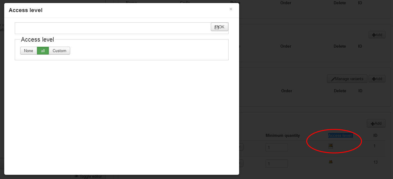

  • Posts: 86216
  • Thank you received: 14222
10 years 9 months ago #222814
Can you check that you have all the user groups checked in the ACL icon of your 125€ price ?
Otherwise, that price might not be taken into account by the system which would have to rely on the other price for the display.
The following user(s) said Thank You: elenora
  • Posts: 13
10 years 9 months ago #222879
Access levels are by both prices set to ALL
