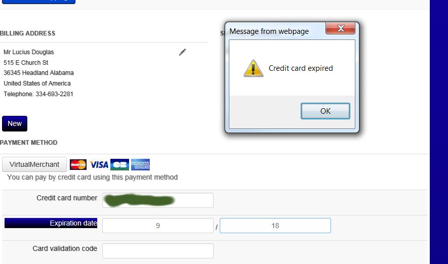

-- url of the page with the problem -- : getrdo.cojm
-- Joomla version -- : 3.4.5
-- PHP version -- : 5.4.43
-- Browser(s) name and version -- : FF / Chrome - updated
-- Error-message(debug-mod must be tuned on) -- : Credit Card Expired
If I put in a valid credit card expiration date of month '9' and year '18', it tells me that the credit card has expired. No matter what year I use, even up to '99', it says the credit card is expired. So no orders can be paid for. I've looked and cannot determine what the issue is.
It's a live site, https://getrdo.com .
Please help!! We have a dead e-commerce site. : :woohoo: :woohoo:

10 years 9 months ago #222744
With HikaShop 3 I have rewrite the "creditcard.js" file and I found something which could explain your issue.
Please edit the file "media/com_hikashop/js/creditcard.js" and replace
var ccExpYear = 20 + year;
By
var ccExpYear = 2000 + parseInt(year);
It will avoid issue of string concatenation with mathematical operation.
If you still have the issue ; please just put a
return true;
and it will skip the date checks.

10 years 9 months ago #222761
Jerome,
I replaced the code but no luck.
/*replaced as per Jerome at Hikashop - var ccExpYear = 20 + year;*/
I even bypassed it but it still clears the fields.
/* bypass expiration year check as per Jerome */
	return true;
FYI, I checked the calculations and it does return the proper year as well as the rest of the code does validate the date properly but somewhere it is not actually working on the form and never gets to the 'card validation code'. The Expiration month and year just clears out.
I am sending you super user credentials if you'd like to take a look.
Luke
  • Posts: 26387
  • Thank you received: 4078
10 years 9 months ago #222807
	var cardexp = /^[0-9]{2}$/;
	if(!cardexp.exec(month) || !cardexp.exec(year))  {
		alert(ccHikaErrors[5]);
		return false;
The month value you entered have one single digit.
And the script is asking for 2 digits.
So you have to enter "09" and not "9"
  • Posts: 332
  • Thank you received: 6
10 years 9 months ago #222864
Jerome,
I would recommend checking for the condition that a single digit has been entered for both month and/or year, convert to a two digit string before doing your validation check. The reason is 'humans are unreliable'. If they have an expiration date of '9/18', you can bet your bottom dollar that a good portion of those shopping will enter a single digit '9' instead of '09' no matter what the display of format shows such as 'MM' or 'YY'. In essence, 'Programming for Dummies WHO SHOP'. :lol: :lol: :lol:

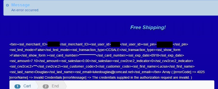

I am getting a 4025 Invalid Credentials message. I've used two different VirtualMerchant account credentials and get the same error message. So is this error message being generated by HikaShop 'before' submitting to VirtualMerchant or is this the information returned from VirtualMerchant? FYI, I do have a 'Cancel url' and 'Return url' setup but this error message displays above the checkout information. I would have thought that if there was some type of problem with the credentials that it would have returned to the 'Cancel url' page.

  • Posts: 86216
  • Thank you received: 14222
10 years 9 months ago #222919
That error message is what is returned by VirtualMerchant.
If their payment gateway says that the credentials you entered in your VirtualMerchant payment method are invalid, I would recommend to check them with their support. Maybe you're not using the correct credentials for your merchant account.

10 years 9 months ago #223032
Nicholas,
In working with the Virtual Merchant techs, it appears that there are two problems with your 'virtualmerchant.php' file. The URL link to send the authorization request seems to have changed. Here are the changes I have made to the file.
if($this->payment_params->sandbox) {
			/*$url = 'demo.myvirtualmerchant.com/VirtualMerchantDemo/processxml.do';*/
			$url = 'demo.myvirtualmerchant.com/VirtualMerchantDemo/process.do';
		} else {
			/*$url = 'www.myvirtualmerchant.com/VirtualMerchant/processxml.do';*/
			$url = 'www.myvirtualmerchant.com/VirtualMerchant/process.do';
In addition, the tech indicated that the merchant id had the 'ID' in caps whereas it is suppose to be in lowercase. So here is the change I made to the virtualmerchant.php file.
	/*'<ssl_merchant_ID>'.$this->payment_params->merchant_id.'</ssl_merchant_ID>'.*/	'<ssl_merchant_id>'.$this->payment_params->merchant_id.'</ssl_merchant_id>'.
I thought you would like to know.
  • Posts: 26387
10 years 9 months ago #223033
Thanks for the report.
We will update the plugin for the "ssl_merchat_id".
About the "processxml.do" and "processxml.do" ; I'll need a confirmation from a documentation because for the documentation I got, the two URL right exists and the "process.do" does not have same results than "processxml.do"
