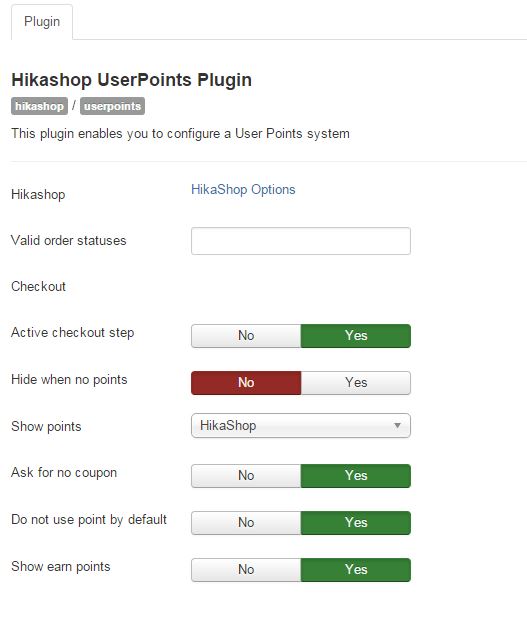

1. Yes. In the settings of the user points plugin, you have the "Active checkout step" setting to activate the use of the "user points" view. Once you do, in the "Checkout workflow" setting of your HikaShop configuration, you'll be able to add that view to your checkout workflow so that the customer can make this selection himself.

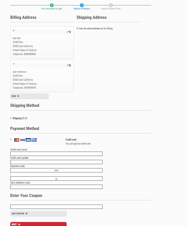

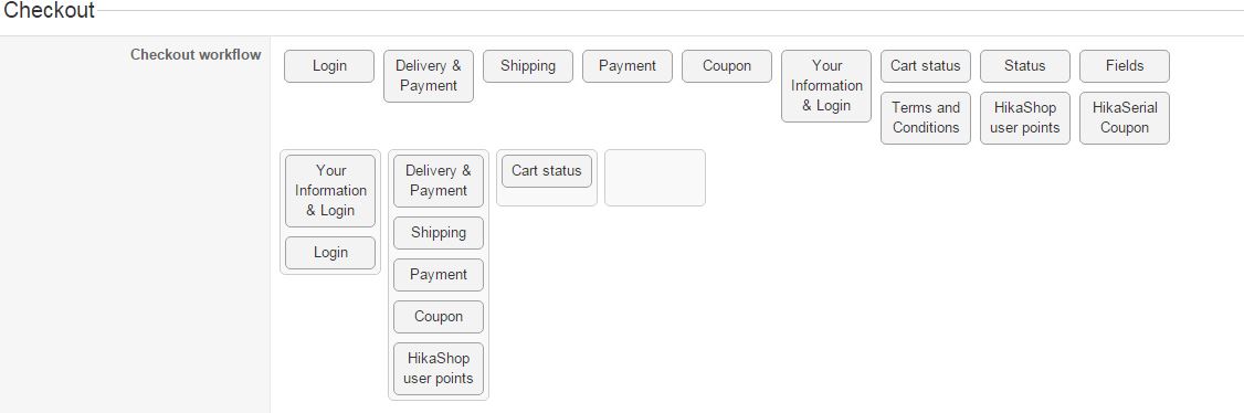

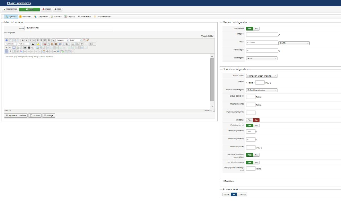

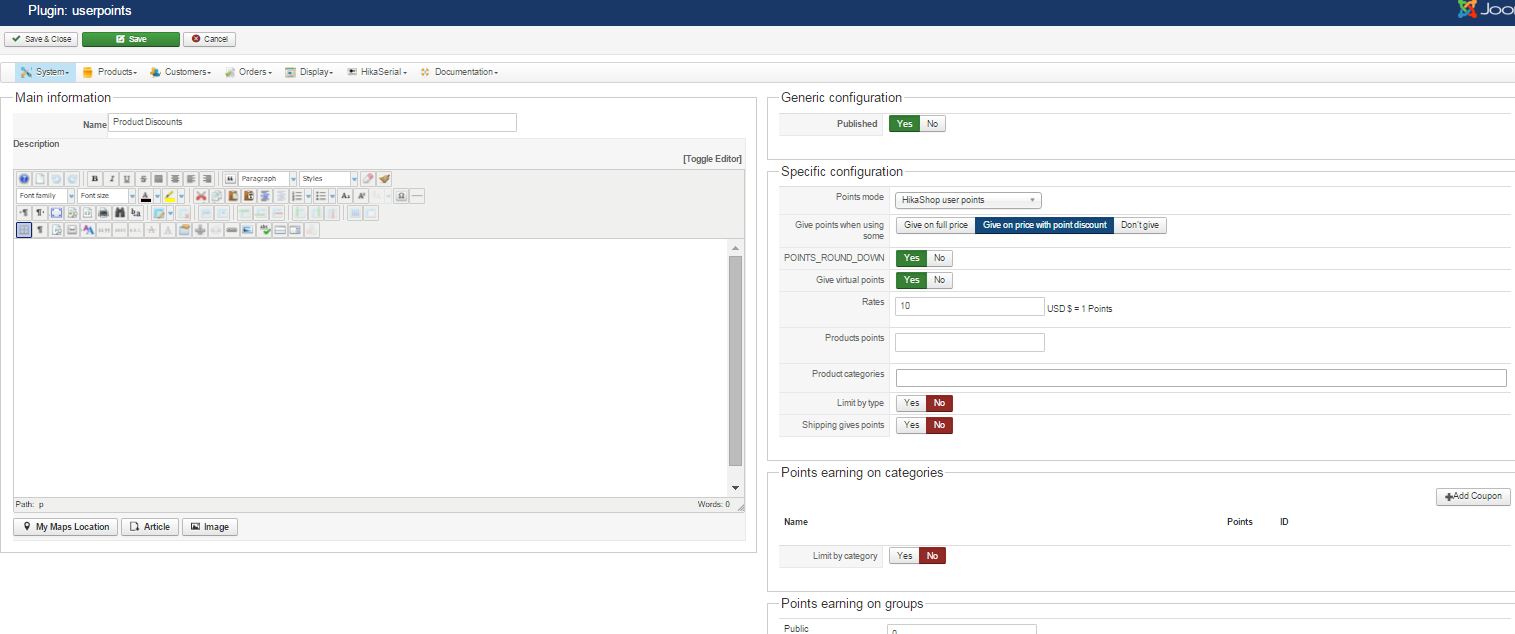

1)I have read through your example and through the entire documentation for user points. I need for the customer to choose whether to use the user points to discount the price. Currently it is automatically taking the points off in the first step of the checkout. I took screenshots of my entire setup I even have hikashop userpoints set as the 2nd step in the checkout.
2) Second issue is I can go through the checkout with the settings below and nothing shows at all for the hikashop user points in the workflow. I believe this is because it is already subtracting all the points off in the first step, but I am not sure?

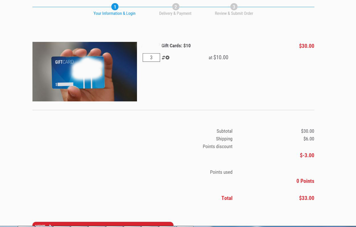

For those of you having problems with this it is because I had virtual coupons enable and it was forcing the discount on the 1st step of the checkout.
