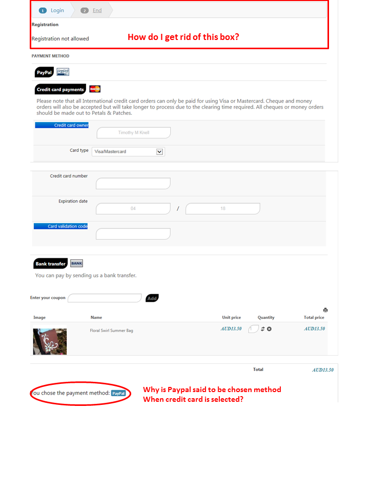

Gudday all
At last I can see a place to enter credit card details!
After entering them what/where do I go now? There appears to be no button/link/location that would take me further.
Attached is a screenshot with my details removed plus 2 questions on the shot.
When my details are entered I still see no option to go further.
I suspect the issue is still related to my inability to get either Australia Post's V1 or V2 working at all but unsure.

You deactivate the registration in your Joomla configuration.
you also deactivate the "login" in the HikaShop configuration.
So, because the user is not logged and can't register ; you got the message.
And because you have that message you can't have a "next" button, so you can't submit the credit card details.

I find myself confused. Do viewers of the site and potential buyers need to be registered to buy something?
I thought the registration was available for those going to a different area of the site.
On my site the plan is to have retail and wholesale area. The wholesalers would need to log-in/register but not retail buyers.
Is my understanding correct or not?

If you want some guest checkout ; you need commercial edition of HikaShop.
www.hikashop.com/extensions.html
Otherwise, like I wrote you in my previous message, you deactivate the registration in your Joomla configuration.
Nobody can create an account in your website, for your entire website, not just HikaShop.
So please read very carefully my previous message for the details.
