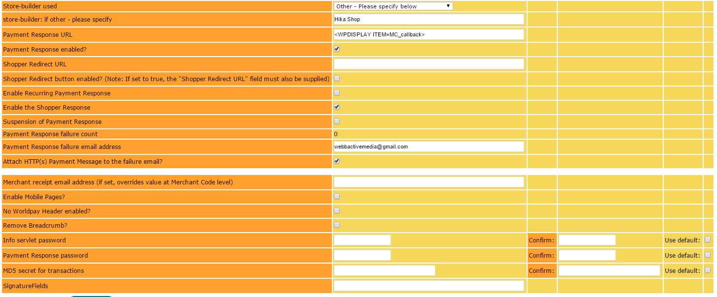

So far, I have the WorldPay (Test environment) settings as:
Payment response URL: <WPDISPLAY ITEM=MC_callback>
Payment Response enabled? YES
Enable the Shopper Response? YES
