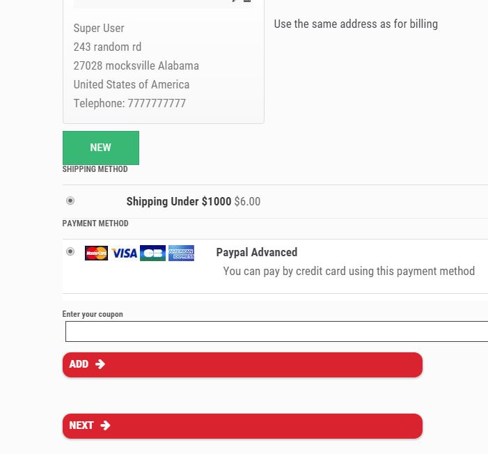

I have a client who is using payflow pro payment method on hikashop. However, I was told by one of the developers here to just use the paypal advanced plugin. I tried this and it works, however this plugin takes you off the site when paying and I have to have the credit cards processed on site.
How can i have my credit cards processed onsite using payflow pro? I have tried setting the type filed to both iframe and form and it seems to have no effect at all. I attached a screenshot of what is happening. It does not allow you to pay onsite.
Edit: Upon looking at this further the way this is working is going to be a problem with this client. I have reviewed the documentation again and it appears that the payment options either popup at the end of the checkout process or opens in a new window when selecting "form". Neither of these options will work with the existing client. They need to pay directly on the site where it says paypal advanced in the screenshot I attached. It needs to function the exact same what the "HikaShop credit card payment plugin" or the authorize.net plugin works. How can i get it to function that way?
www.hikashop.com/support/documentation/2...aladvanced-form.html
I just though of something would Is it possible to at least make the iframe load below where it says paypal advanced instead of on the final step of the checkout?

The iframe mode of the PayPal Advanced plugin will display the credit card form directly on the site in the last step of the checkout.
It's not possible to do differently and have it below the payment method name like with authorize.net or the credit card plugin.
If you want that, you need to use the PayPal Pro plugin, which display exactly like that.

Nicolas thank you for the response.
However, the company is using payflow pro as their gateway and not paypal pro so that will not work. They do that because they have someone 3rd party process their credit cards because it is cheaper.
It is possible to process cards on site using payflow pro because on their current site they are using wordpress and this extension and it works the same way as authorize.net.
shopplugin.net/store/paypal-payflow-pro/
According to the payflow pro documentation you can process credits onsite like authorize.net without an iframe.
Am I going to have to have someone create a custom plugin to do this on hikashop because it appears this option is not currently available? I have seen other people request this as well. I would think it would be beneficial to create this as another payment option in hikashop.
Paypal pro is not always a good option for everyone because you have to process credit cards through paypal and a lot of people do not want to do that because it is more expensive.

The implementation without an iframe is not in the PayPal Advanced plugin so that's why it's not possible to do what you want with it. If you need that, then yes, another payment plugin would be necessary.
