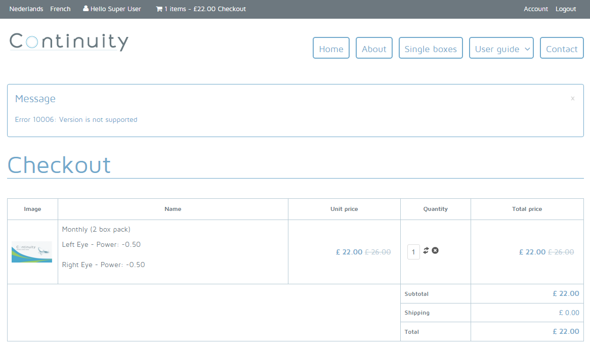

We changed the line to '200' and got a different error message:
Error 10006: Version is not supported. See attached screenshot.
We also noted on the PayPal site, we could set the version to '201' or '202' etc. We tried this but it did not work either.
Do you have any further suggestions?
